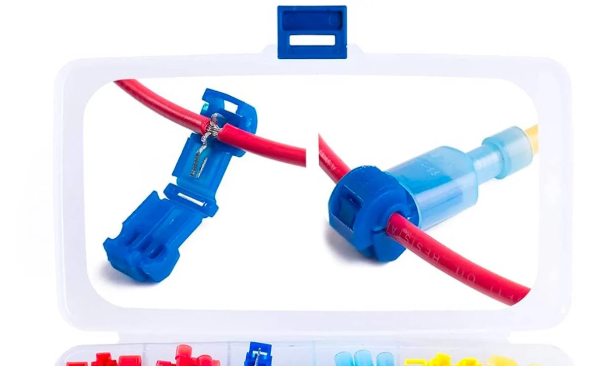

unfortunately no. they could have tapped into any powered wire using something like this. It would be tedious but you could remove your fuses one by one and start your car until you don’t get them sound to narrow it down then use a wiring diagram to track it down.
