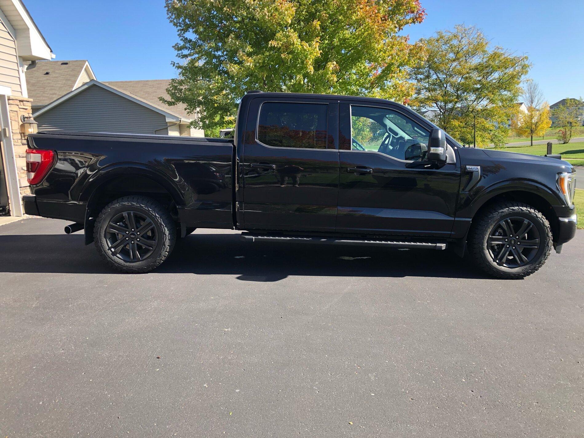

Bilstein 5100's front, set at 1.5" lift
Removed 1.25" blocks in rear (installed air bags, airlift 5000)
1" total rake front to back. 39.25" front, 40.25" rear
BFG KO2's in factory size, 275/60R20
I like. I have the stock tire size also. Mickey baja boss 275 60 20. I was thinking of only going 1.5 in front. Do you have pics of it before removing blocks?
I did a before and after post here: https://www.f150gen14.com/forum/threads/anyone-remove-rear-blocks.3779/
My 'leveling' process was rather complicated though, as I
1. removed the rear blocks.
2. Added air bags in the rear, which raised it back up almost an inch or more.
3. added the 1.5" lift shocks in the front.
Ford F-150 Show me your leveled trucks! 6F0255DB-2435-407B-8836-17ADD0E1CB38
Ford F-150 Show me your leveled trucks! 21F150 side lugs calipers
