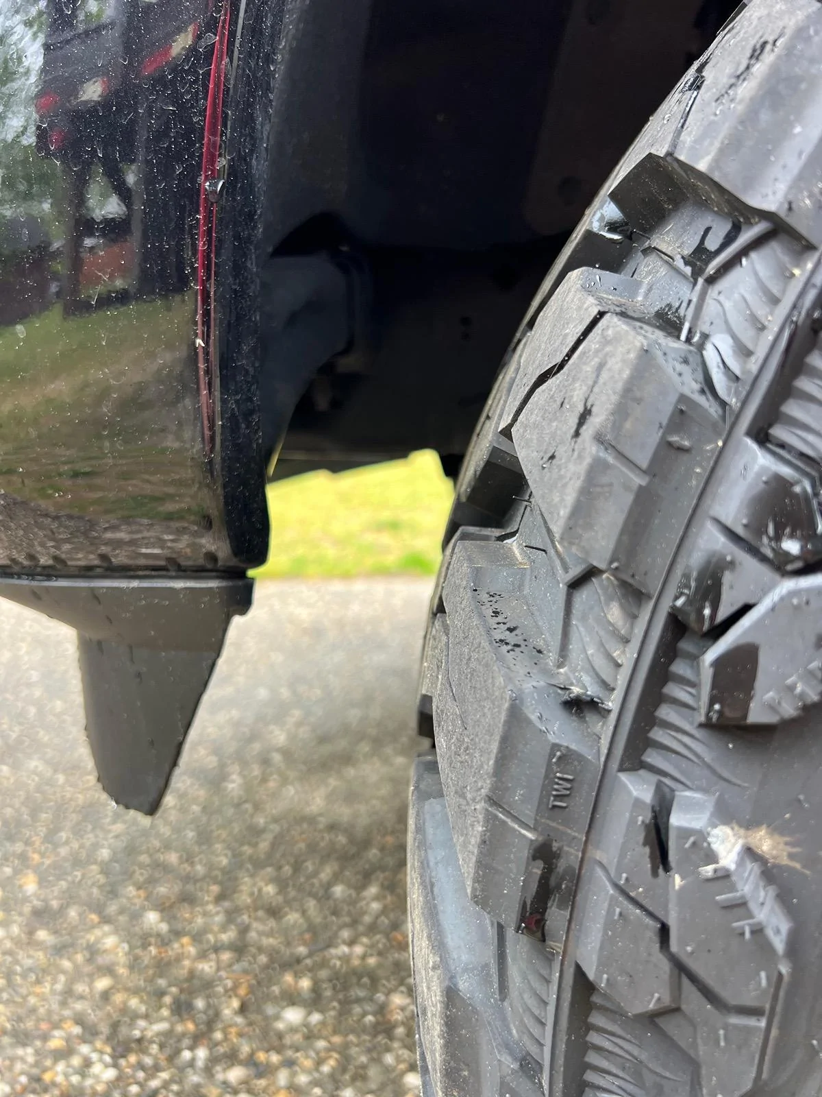

I’m running 20x10 -19 wheels with a 33x12.50 (32.5x12.50) on an 2.5 level and just rubbed the lower valance enough to trim about an inch of it. It only rubbed at 100% full turn. Haven’t had any issues with severely sloped driveways or entrances at all.
Ford F-150 20x10 -18 on leveled truck? IMG_1105
Ford F-150 20x10 -18 on leveled truck? IMG_1106
Ford F-150 20x10 -18 on leveled truck? IMG_1107

Good to know that a 33x12.5 will fit without too much work if any. I might just end up going that route if 34-35” tires require too much work. Thanks for the pics!
