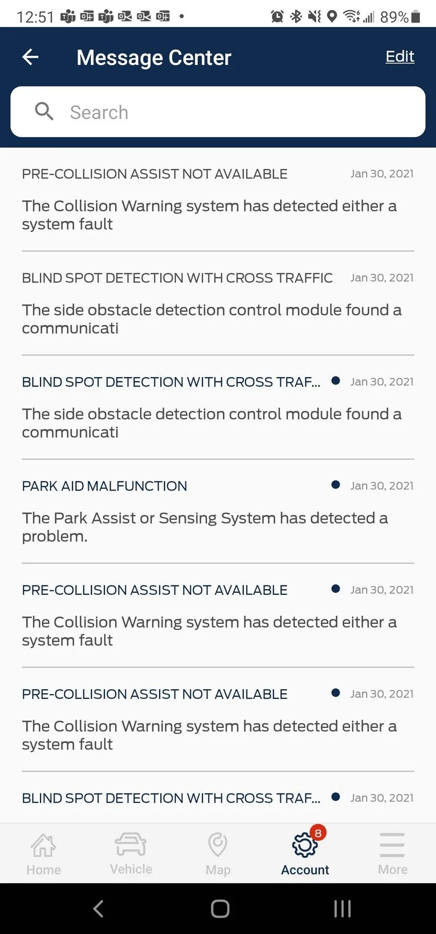

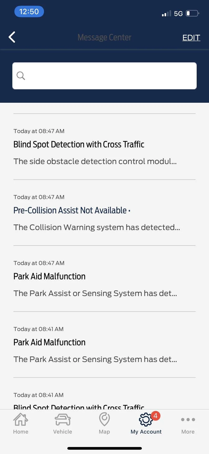

I have this identical issue. I have also done all the steps mentioned in this post. Still get the error messages on the dash.
I have the IDS laptop/VCMII, I have Forscan. I've run most of the module configuration.
When I do the procedure to align the IPMA mod, it seems to work. It doesn't, the errors don't go away and the DTC always says calibration missing.

question.. this thread shows people's faults going to what appears to be your ford pass app. or am i mistaken and that's an in the truck error log? if ford pass... do we have to throw a switch to make those appear (as opposed to the marketing crap ford is putting in the messages?)
