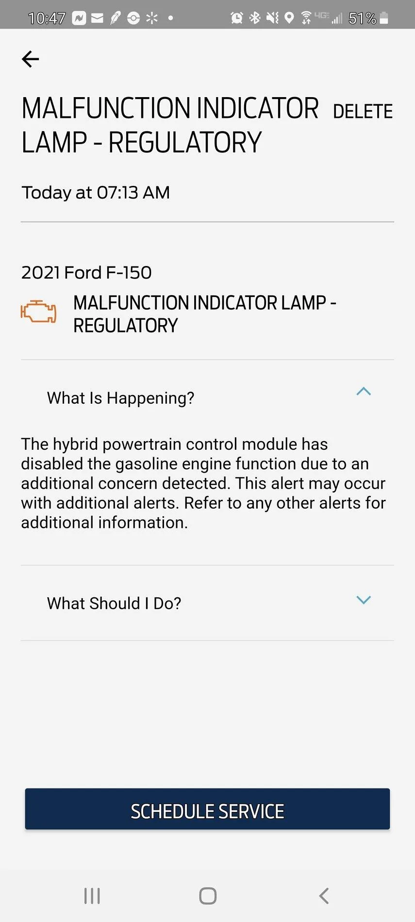

This is what mine was
Ford F-150 Powerboost threw 2 faults Screenshot_20211115-104754_FordPass

Wow. Did it really disable the gas engine? Unless your dealer is really really close, I see a tow truck in your future.

It was weird because when I started the truck it started like a normal truck ( meaning I turned the key and the starter engaged)not like it normally does then immediately cut off. Started it again and got it moving it stayed in limp mode for about 1/4 mile the went normal. I have an appt first thing in the a.m. we will see

Went to dealer and it turned out to be a misfire on cyl4. There was a TSB and they reprogrammed... in and out within 20 minutes.
