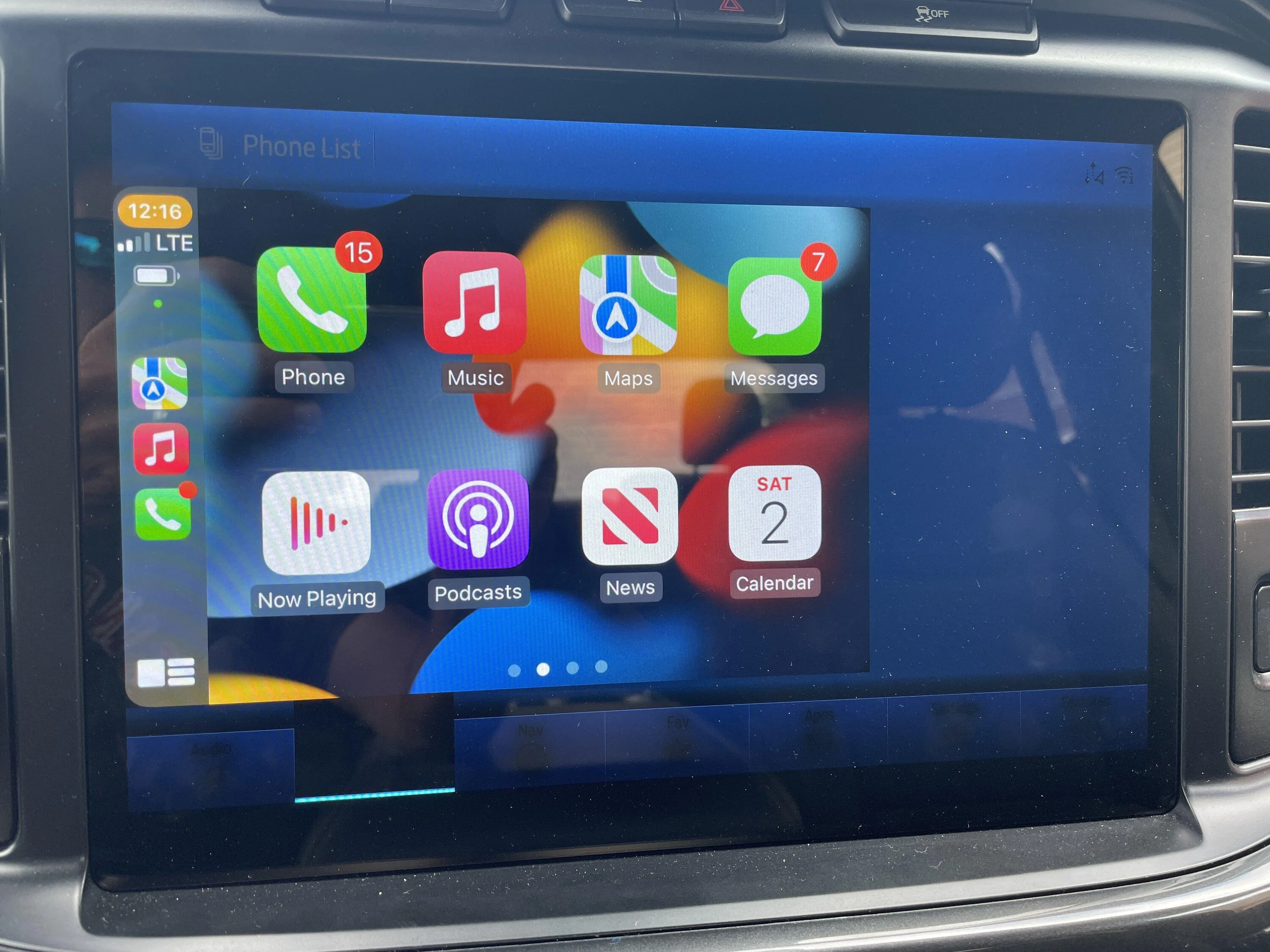

I may be wrong but I bet you had the same thing that happened to me. Ford pushed an old OTA to my truck (which was up to date) which overwrote the APIM with an old version. Mine looked exactly like yours and acted the same way (Carplay/Backup Cam). @Jesse-Infotainment was able to get me an updated APIM set of files, installed like I normally would and everything is back to normal. See below what my Sync looked like.

It loaded the wrong set of files. It loaded the 8" nresolution. I can send you an update to load onto a USB and it will fix it. If you want to deal with the dealer you can do that also. The USB fix is easy
