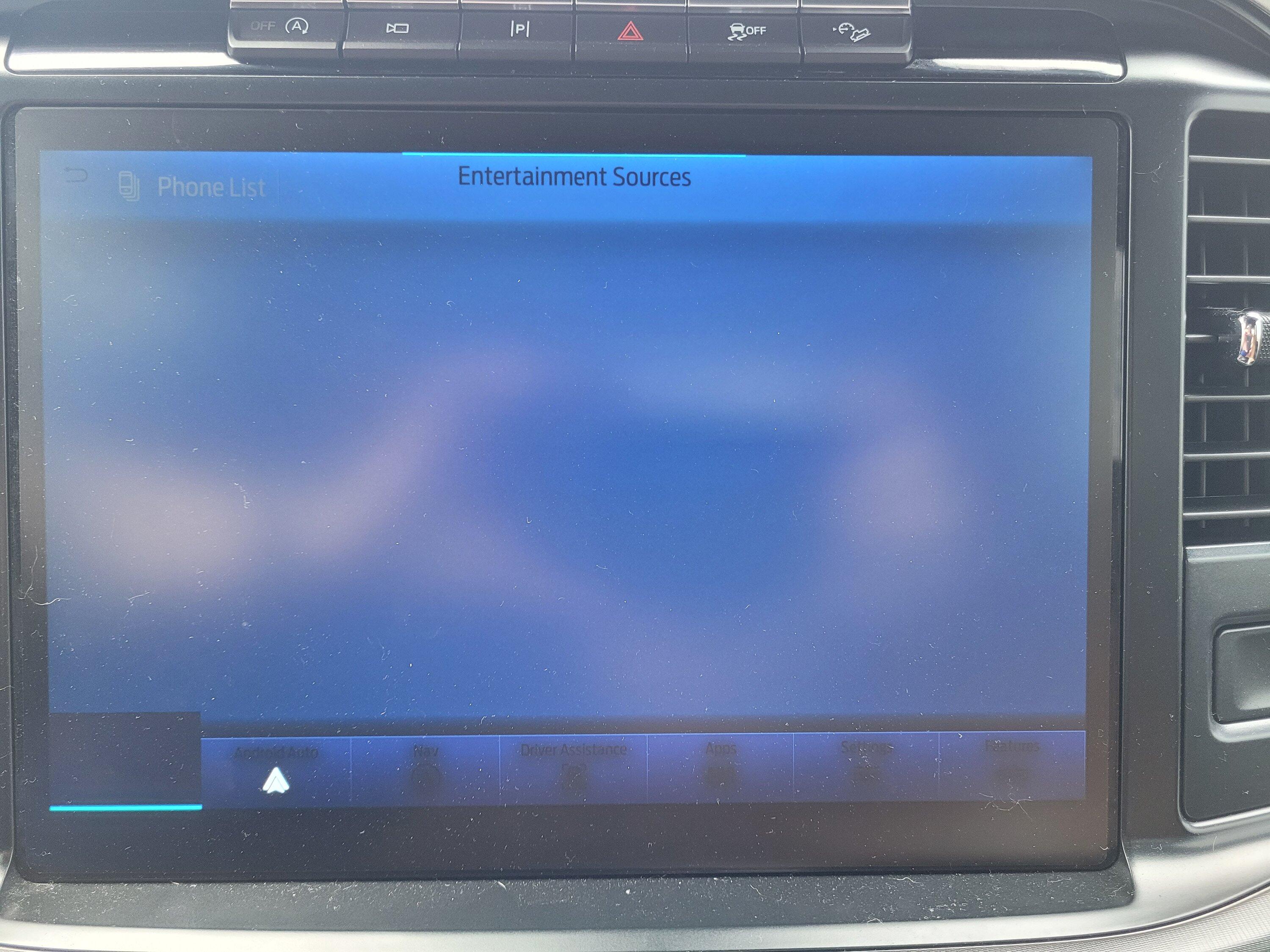

Can confirm it's not the APIM. I had the exact same issue this past weekend and everything is good now after installing the correct software from Jesse.
Ford F-150 Screen issues on 12 inch screen 20220729_153543
Ford F-150 Screen issues on 12 inch screen 20220729_153658
Ford F-150 Screen issues on 12 inch screen 20220729_151052
