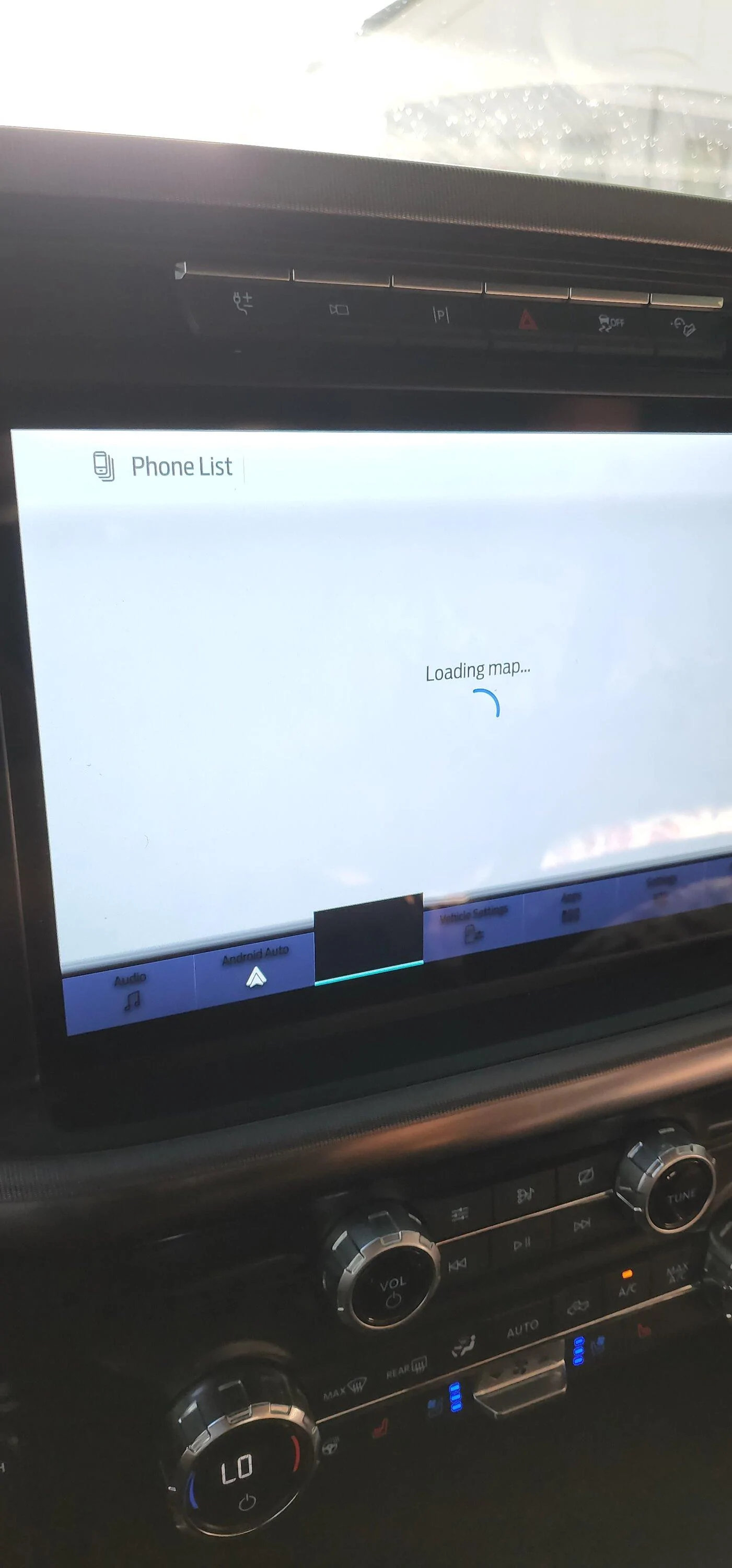

Anyone having issues with their screen font looking weird and right hand side panel displaying? Just had an update yesterday and my screen looks like this. Also odd is that my truck won't tell me what update version I'm on

you have android auto on??

I do! But tried turning it off. My audio screen is also just blank...ttied restarting and everything (powerbutton + ff button)
Yeah. If you want me to send you the files send me your vin

It worked! Thank you Jesse, hog, and speed! Can't believe this is an actual issue that can happen
Awesome! It's mind boggling that Ford doesn't have a simple check on their OTA's. If OTA version being pushed is older than current version on truck, DON'T FREAKING INSTALL.
