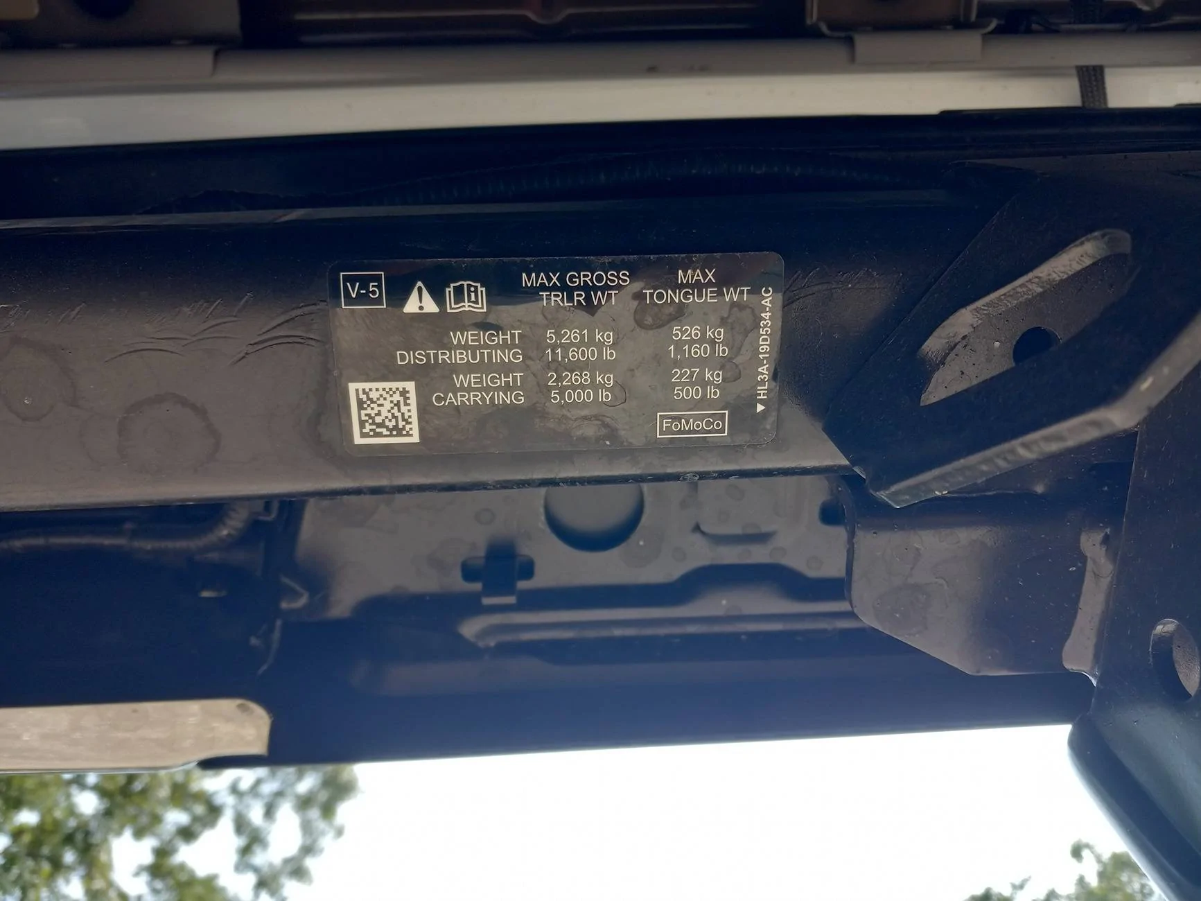

This is the sticker from my hitch, on a truck with tow package but not max tow. As you can see, to get the most, you'll be needing a weight distribution hitch. I really like my WeighSafe, because I can know the tongue weight of each load and easily adjust it.
Please note that sticker reflects the receiver's rated capacity only, not the truck's rated capacity which may be (most likely is) lower.
The attached guide or this online VIN-specific towing calculator may be useful for determining the truck's rated capacity.
