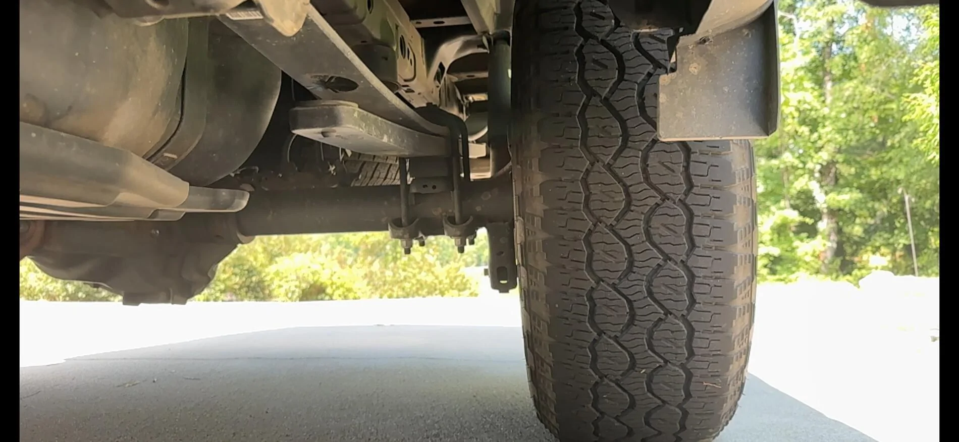

thanks for the reply. I don’t believe mine has the Max towing package. There is just the one that spans the full length with a helper in the middle. I attached a pic to be sure. And yes push would be a better description of the cornering feel. It definitely doesn’t instill much confidence on corner entry.
