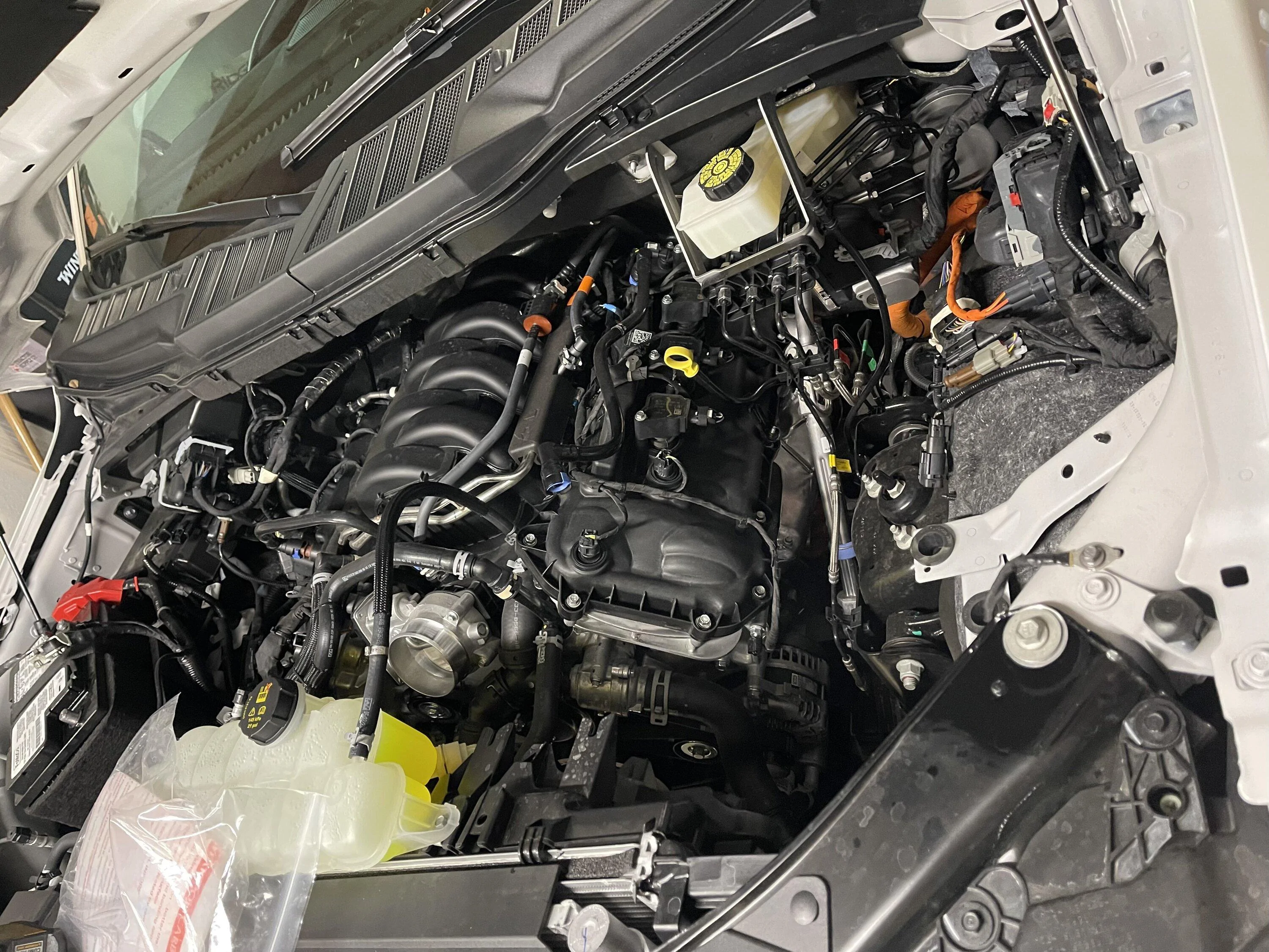

I had a Roush and wound up removing it in favor of an aFe. The aFe is a bigger filter, a bigger piece of rotomolded plastic and replaces everything vs the Roush kit which replaces very little; Cost difference isn't much, and install was actually easier for the aFe because I wasn't trying to reuse a bunch of stuff. I have a Cervini intake hood with the bottom half of the air duct installed (i.e. it's a functional scoop hood) so I have the window removed from my CAI to allow the air from the hood to flow in the top. It's not a perfect seal, but this is a turbo engine so the intercooler and/or upgrades to the intercooler and duct affect intake temps more than air temp at the air filter.
Anway, I'm sure that the Roush is fine, and I didn't have any issues with it, but if I had this to do again I would've gone with the aFe first.
aFe momentum GT
Edit: with regard to power, I don't think that you'll notice any change beyond placebo effect with a single bolt-on, and even if you do a full set of bolt-ons (CAI, intercooler, exhaust) you really need a tune and premium gas or E85 to take advantage of it. The holdup for me has been the exhaust heat exchanger on the PB, which we're STILL working to delete without breaking things/getting eternal CELs and/or engineering a new truck. I bring this up only as a cautionary tale: performance is limited by the weakest link, which will ultimately be your air delivery, your injectors, your turbos, your fuel octane or, ultimately, your pistons.
I do notice the turbo noise MUCH more than stock even with a noise/heat blanket on the underside of the hood, but I like the noise and it's only when I step on the pedal at speed, so I don't regard that as a downside (others might).
