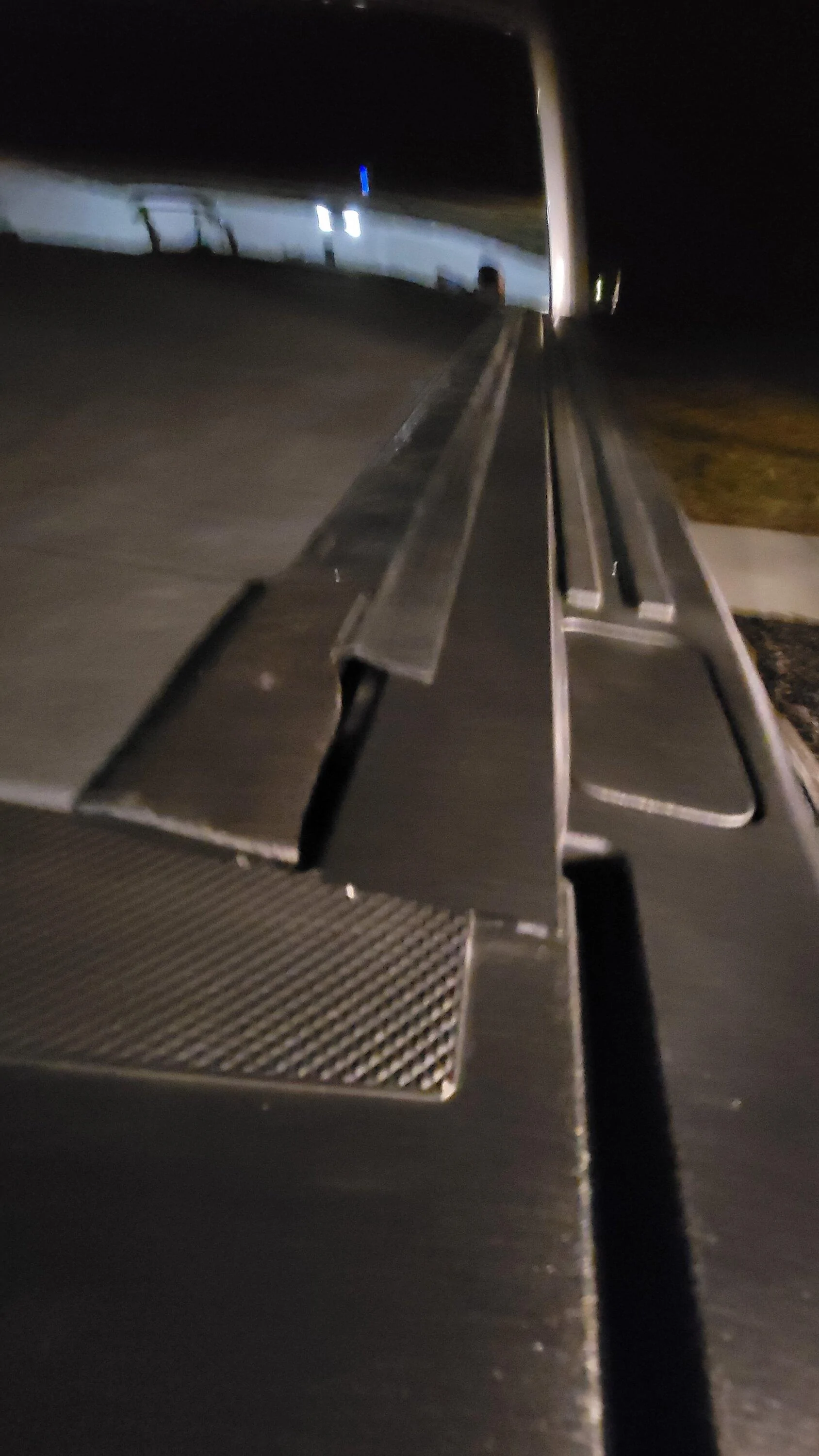

Ironically, I installed mine yesterday and one of the corners had a piece brake off during shipping and the other completely fell off when I was unrolling the cover. I have an email out to Bak Industries support and have heard good things about their customer service.

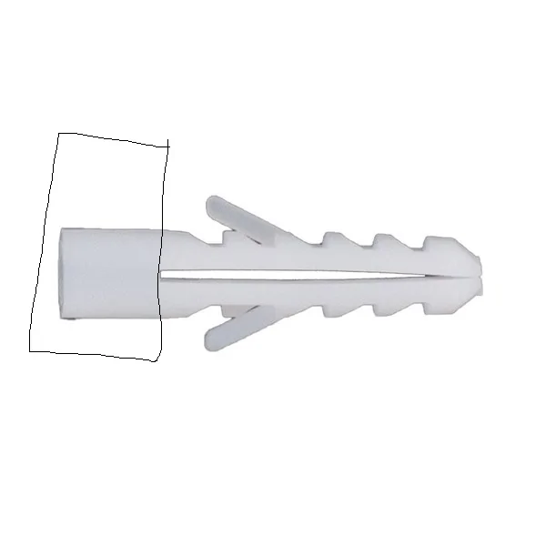

Hey guys. I ran into the caps popping off too. I found a quick and easy fix. On the backside of that trim cap, there is a POST. That post goes through a hole where it snaps into place. My passenger side keep popping off when rolling mine up. So what I did was this.
Go find some plastic dry wall anchors. I had many in my junk draw in the garage. I found some that are the same circumference as the plastic post on the trim cap. I cut the heads off the top of the drywall anchor and used them as a lock washer by pushing them over the plastic post on the trim piece that goes through the stationary mount. I did add a single drop of super glue to the washer I made. Now that trim piece is NOT coming off. BAK is sending me 4 new ones so I figured I would try this. So far so good. Mine do NOT pop off anymore.
I would post a pic of this installed so you can see what I did, but the wife stole the raptor today!
So here is what you do. Find plastic drywall anchor same circumference as the post. Cut the top part off. With your trim pieces installed, roll up your cover so you can see the backside of the trim cap. You will see the U shaped pressure arms that hold it down. And you will see a POST as well. Take the end piece of the drywall anchor you just cut off and tightly slide that over the post with a small single drop of super glue. No more trim parts falling off!
Ford F-150 Revolver XS corner cap broken std-anchor
