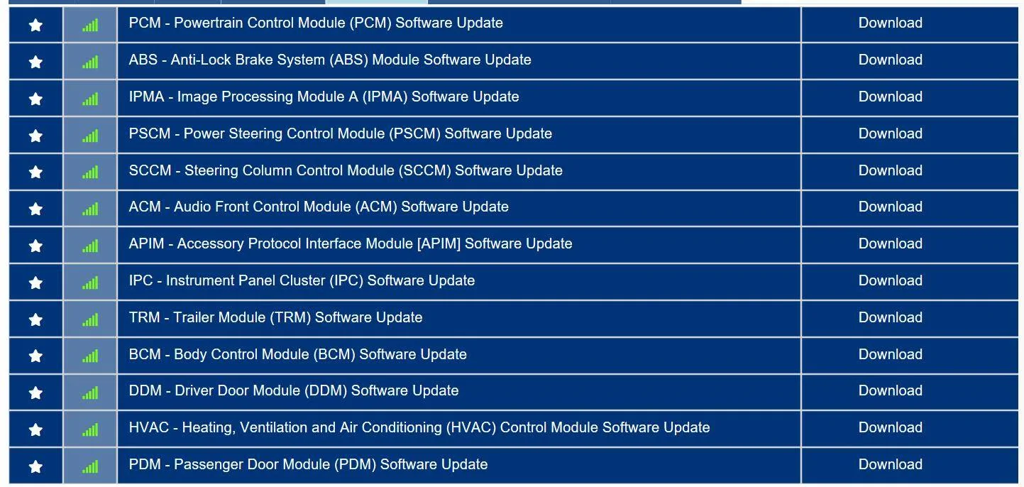

darn - so they're not being honest with me then. Can you tell if i'm far behind? i might do the TSB that came out to update all the modules - hoping to get the airplay disconnecting and lack of audio issued resolved...
You're not missing anything of note, you already put the BC 1.4 initial on it. TRM and xDMs are new and don't really fix anything we've seen.

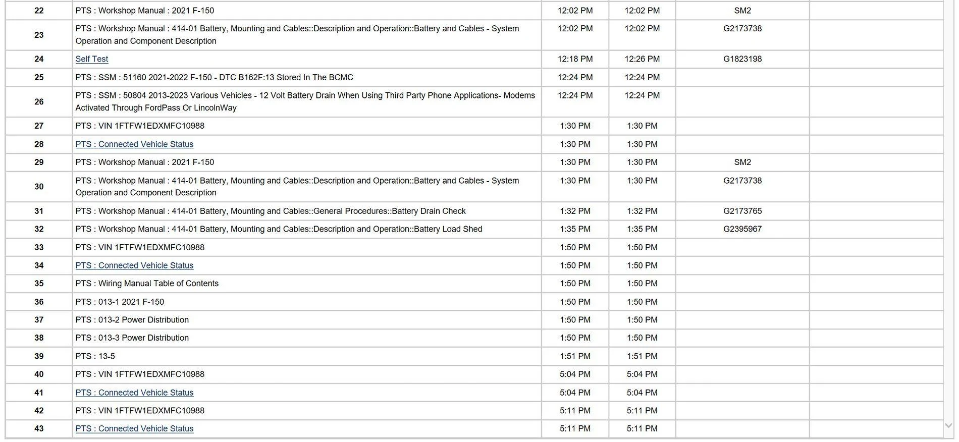

Ford F-150 Request VIN Lookup Thread 1741632242222-uj
Here's from your dealer trip
