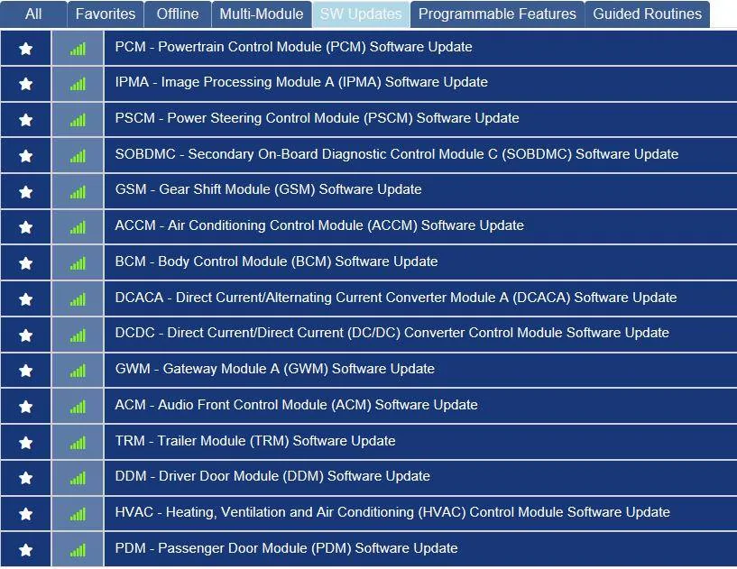

Thanks in advance for the info! 21 powerboost xlt 1FTFW1ED6MFB55505 - Update status would be great. If it's not too much trouble, finding the module status as well - i have had it in multiple times and finally got replacement sunroof but not sure if other things have happened while it was there. Thanks!

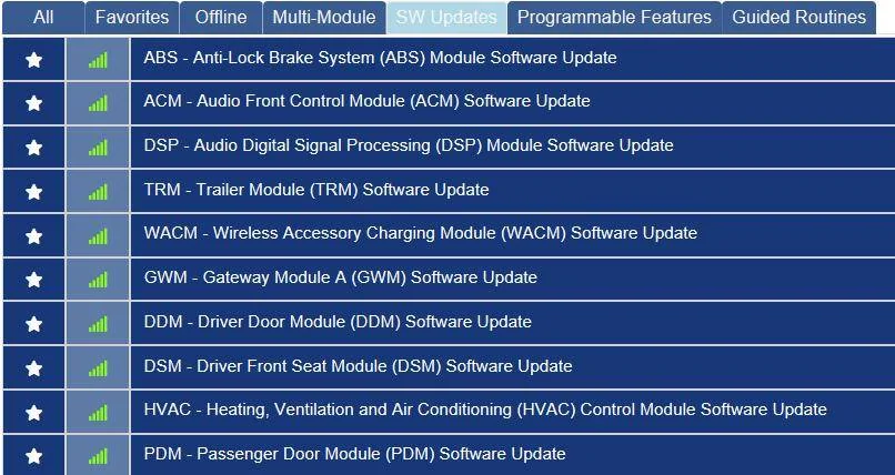

Which version of FDRS are you using?
If Ford released it for your VIN, then it should, but it is not guaranteed.
Only way to find that out is going to be with PTS?If Ford released it for your VIN, then it should, but it is not guaranteed.
The latest one 41.5.2Which version of FDRS are you using?
Or FDRS to see if it shows. Sometimes a network scan with FDRS can release updates that won't show otherwise.Only way to find that out is going to be with PTS?
Okay. I guess I’m going to buy a month license to do the updates and hopefully it will release itOr FDRS to see if it shows. Sometimes a network scan with FDRS can release updates that won't show otherwise.
I think 2 days will suffice.Or FDRS to see if it shows. Sometimes a network scan with FDRS can release updates that won't show otherwise.
Okay I’ll do that then cause I have a lot extra to updateI think 2 days will suffice.
Yep, just as i thought. I need a bunch. This is a 2021 built in march 2021. I have been trying to read this thread to not ask stupid questions but man there is a lot on here. It looks like my only options are dealer which is 3-5 hrs away for me or the mongoose which has a pretty decent wait on the threads here. I saw some people saying the APM for the early build 2021 needs to be replaced to upgrade? If i replace the rear 12v battery will this help with updates(sounds weird but i read it on the internet

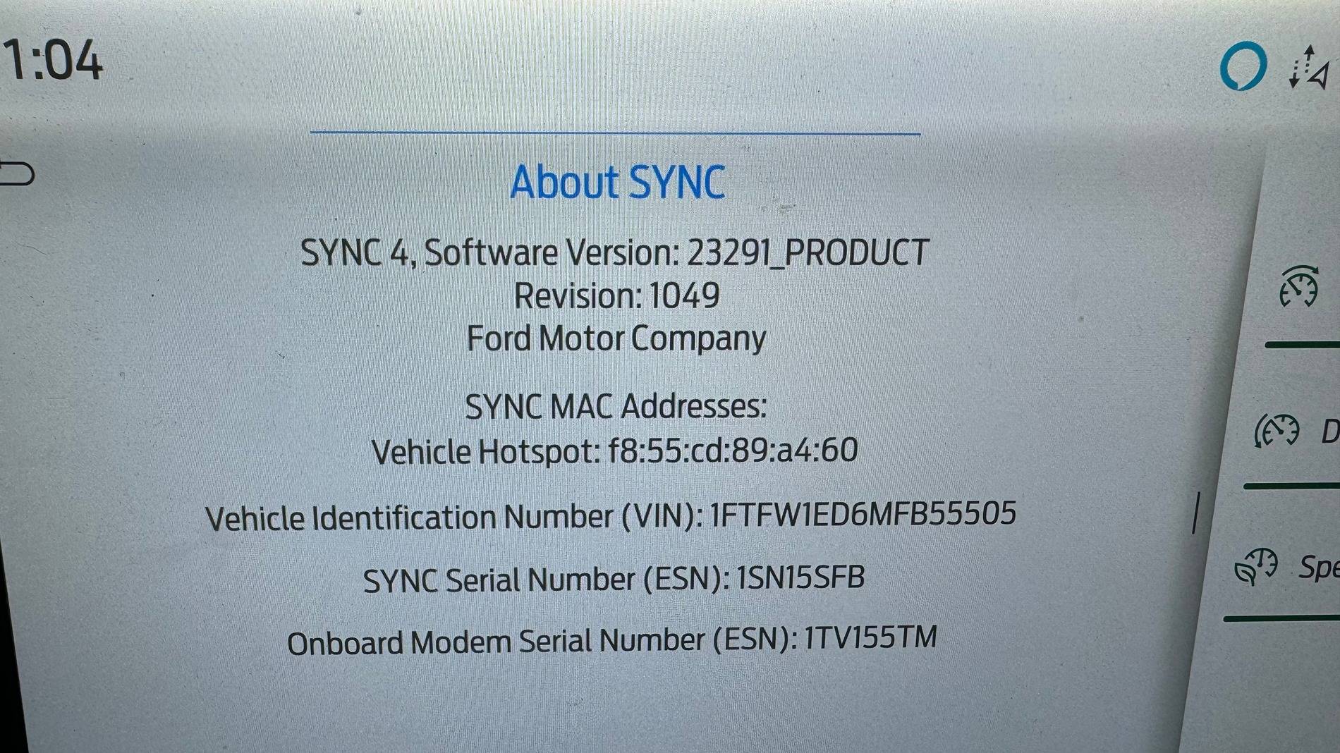

What does your "about sync" screen say?Yep, just as i thought. I need a bunch. This is a 2021 built in march 2021. I have been trying to read this thread to not ask stupid questions but man there is a lot on here. It looks like my only options are dealer which is 3-5 hrs away for me or the mongoose which has a pretty decent wait on the threads here. I saw some people saying the APM for the early build 2021 needs to be replaced to upgrade? If i replace the rear 12v battery will this help with updates(sounds weird but i read it on the internet)
