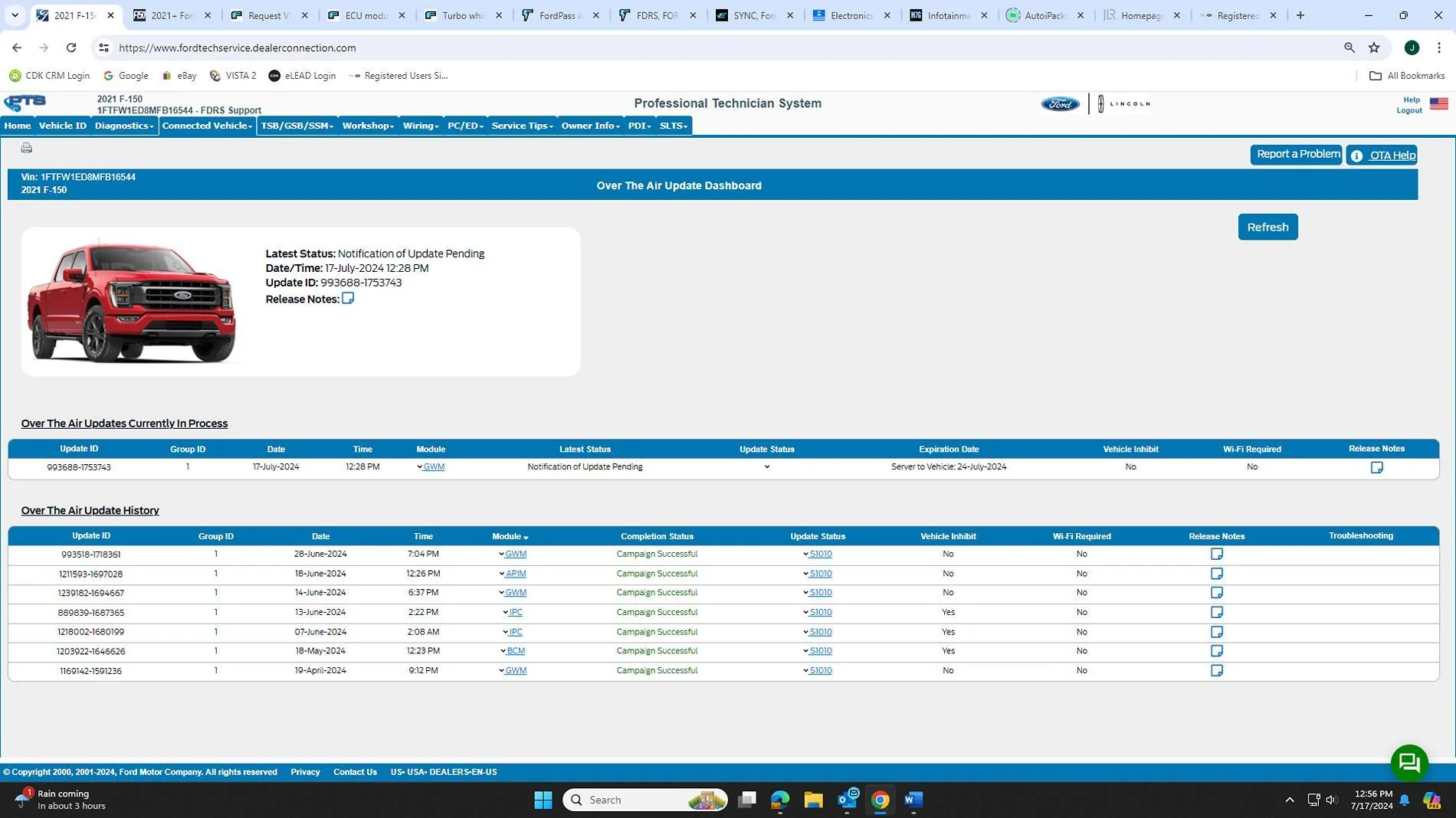

Could you check mine? 1FTFW1ED8MFB16544
I took it to the dealer a couple of months ago and they reprogrammed a module after I complained about the speakers popping.
The popping stopped, but then I got what looked like and old update and the popping returned. I got more updates over the next few days, but they have stopped, and the popping is still there.
OTA history is below. No updates have been sent to your ACM or DSP that would cause this. Btw, OTA 6.2.0 was sent to you 20 minutes ago and is sitting in your queue. Start the truck and let it run for 10 minutes or so and that should be enough to get it to go through.
Ford F-150 Request VIN Lookup Thread 1721235408056-af
As far as the speaker pop, @HammaMan mentioned something about this recently being caused by the ACM or the APIM. Not sure what the fix is, though.
https://www.f150gen14.com/forum/threads/ecu-module-programming-guide-using-fdrs.8249/post-482610

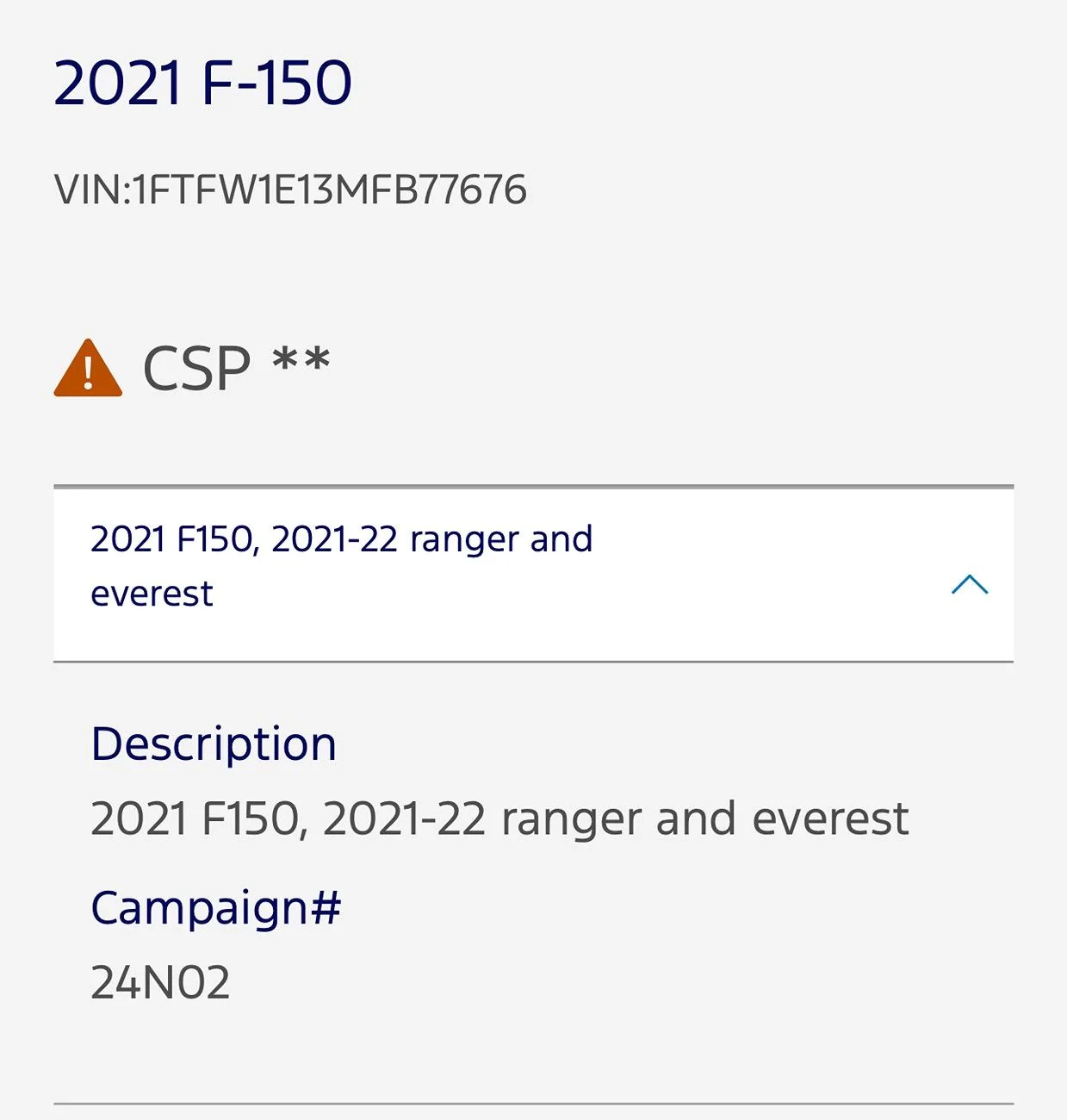

Can you check what this campaign is for my truck?
Ford F-150 Request VIN Lookup Thread IMG_4779

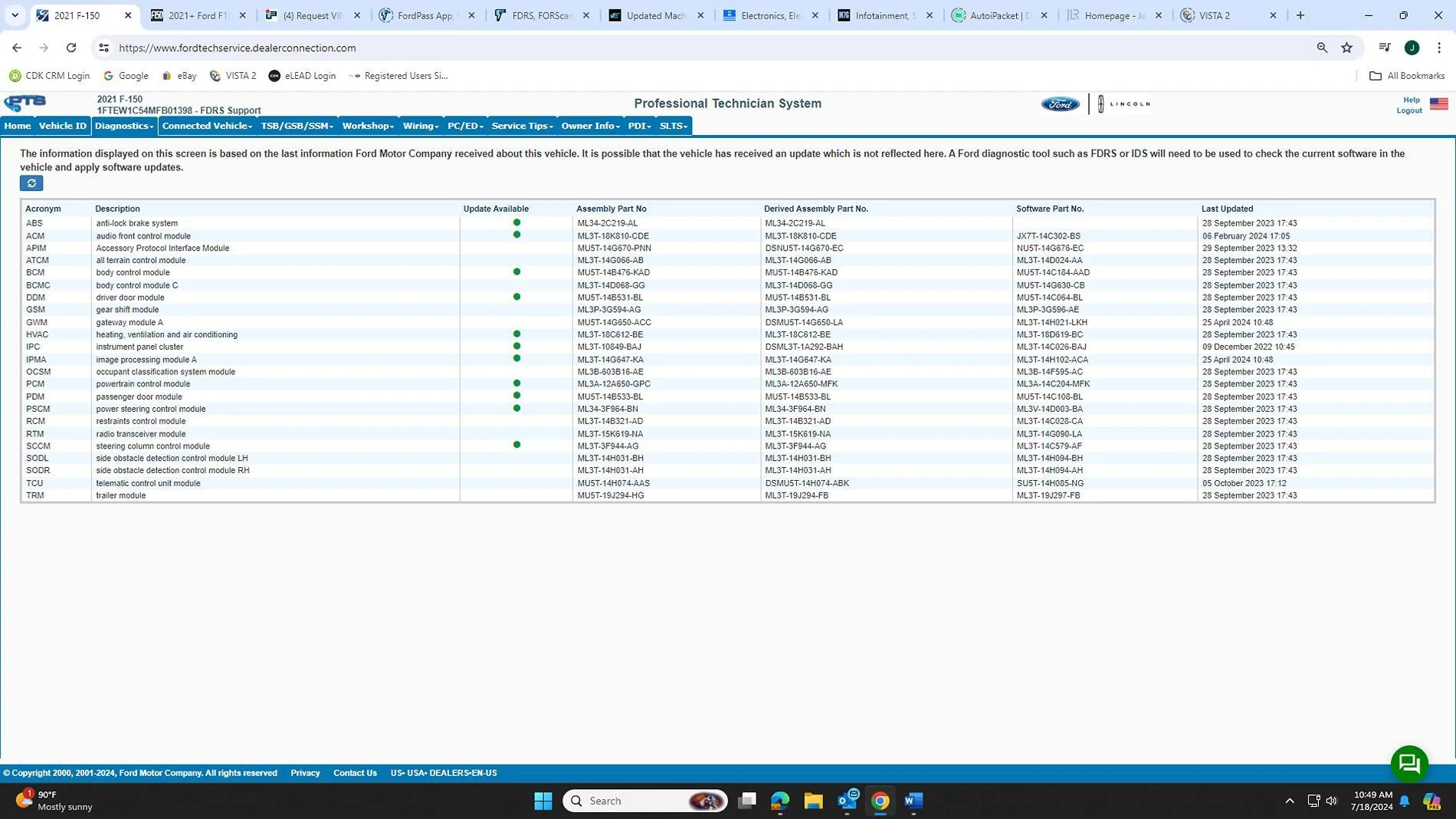

1FTFW1ED5MFD11615 - Keep getting phantom updates. Have to reset my view. Can someone please check to see if something is going on with my truck and OTAs. TIA
rugedraw
Javier
Dec 14, 2021
7,413
9,008
Miami
Auto Sales
No OTA action since you got 22-PU1009-TLC-CSM2 in May. You have a lot of modules pending updates, but your truck is on the latest Sync version. Try rebooting the APIM to see if it makes the message go away.
