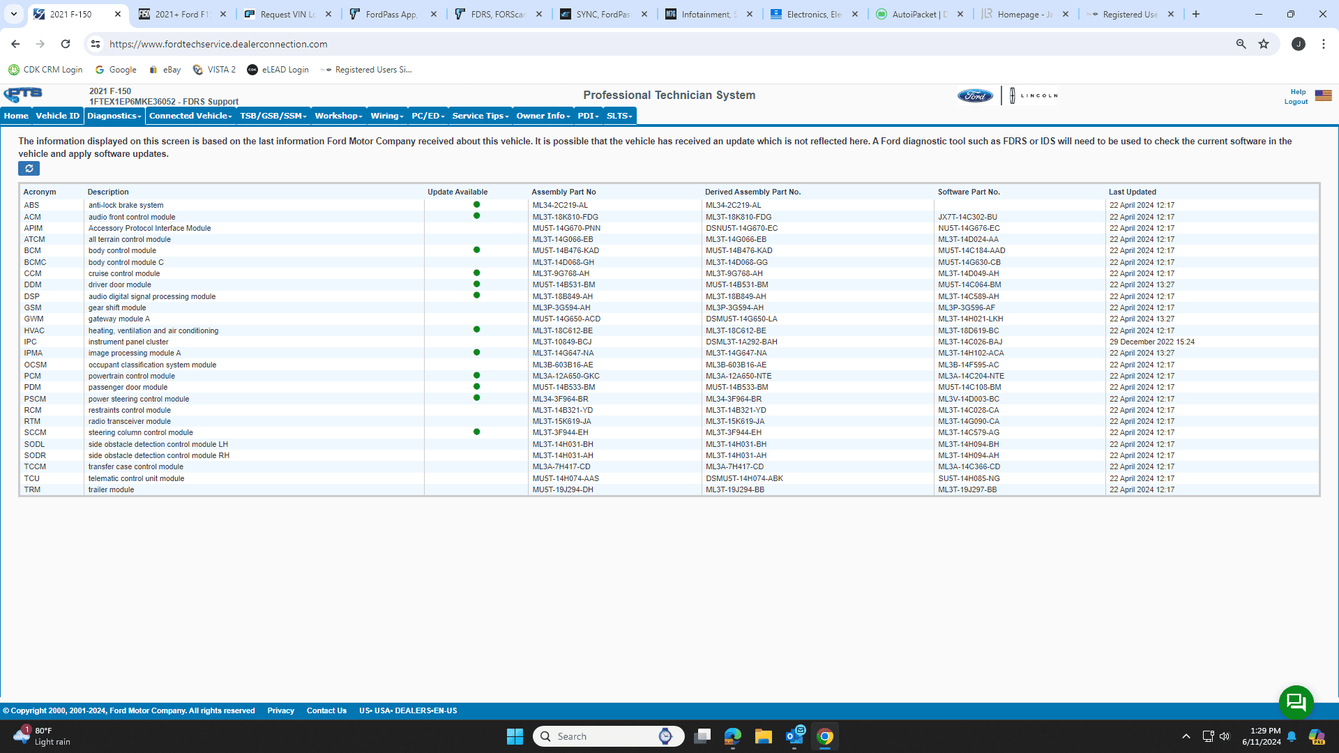

I’d like to see where im at, the trucks only semi recent update was the improves connectivity one in April. Thanks
Yea, that's the only update in recent history you've gotten. Your truck is on Sync 23159 which is just version behind the latest which is not terribly behind. Modules with pending updates are below which do not include APIM, GWM and TCU updates you still have pending too. Your truck is fine; just gotta wait for more to be sent.

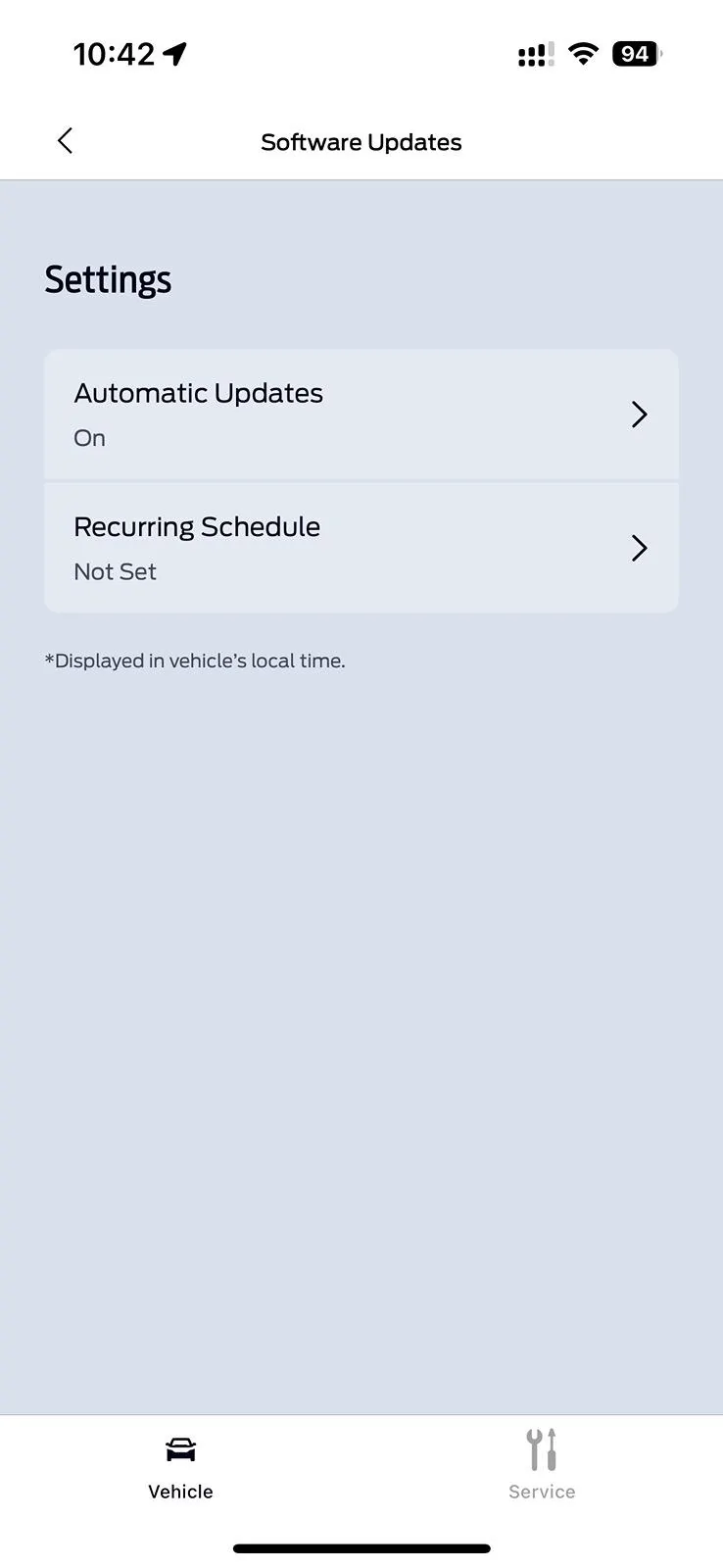

Looks like you might be safe. Are you able to toggle the auto-updates feature on and off?
when this first happened I toggled them from on to off the back on but was unable to set a schedule today when I tried they were set to off I toggled them on and was able to set a schedule so well see how it goes.
Also looks like I have received another update since I took the last photo so thats a good sign I would thing.
