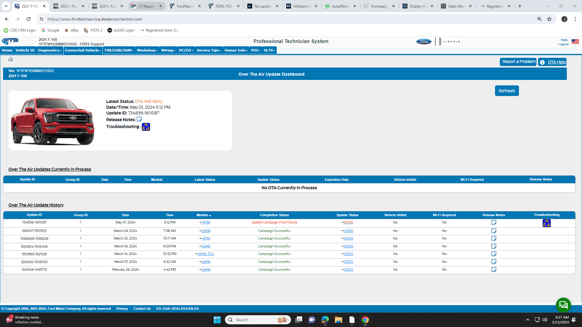

Someone mind running 1FTFW1E86MKE51022 on PTS to check OTA status please?
OTA history is below. APIM update 3.5.3. failed due to having problems downloading the files. That update has always had issues downloading since it was first released a long time ago. That is the update that gives you full screen phone capability.
Thank you! What is the suggested path forward? Let it try again or FDRS intervention?
As far behind as you are, I would have FDRS'd that b*tch a long time ago. The waiting list is short right now to borrow a Mongoose from me, and I have a total of 4 in them in rotation now.
If it was my truck I’d FDRS it too ? I keep mine fairly up to date. This is someone I’m trying to help remotely
