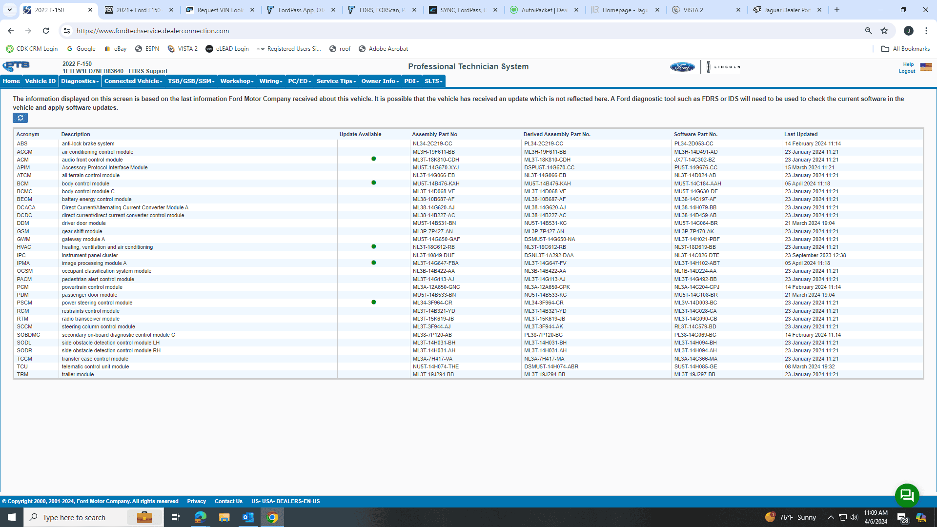

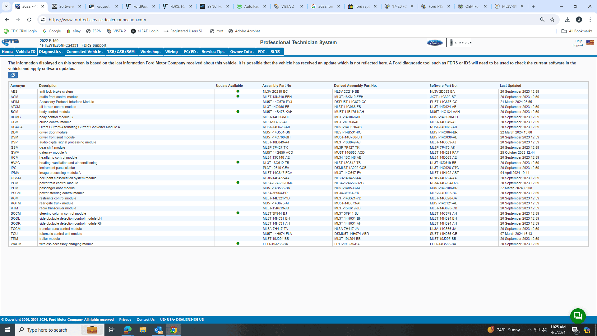

Would someone be so kind as to check my outstanding downloads/software updates please ?
1FTFW1ED4PFC63772
1FTFW1ED4PFC63772
Looks like you have an OTA that is still trying to complete or never fully completed successfully and reported back as such. It is the 23-PU1113-UNX-DC that many of us have been receiving.
Ford F-150 Request VIN Lookup Thread 1712632778405-6i
You have quite a few other modules that need updates as well the FDRS way.
Ford F-150 Request VIN Lookup Thread 1712632691257-6f

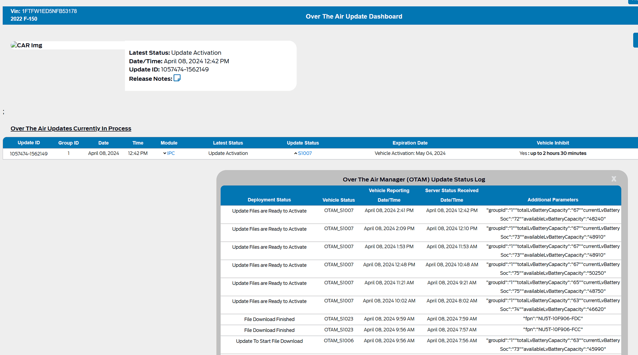

@rugedraw
Can you check if there is any available updates for my truck.
VIN# 1FTFW1ED5NFB53178
Thanks
You have a IPC OTA in the queue right now trying to run and it might tonight depending how you have your OTA updates set.
Ford F-150 Request VIN Lookup Thread 1712633284859-vx
