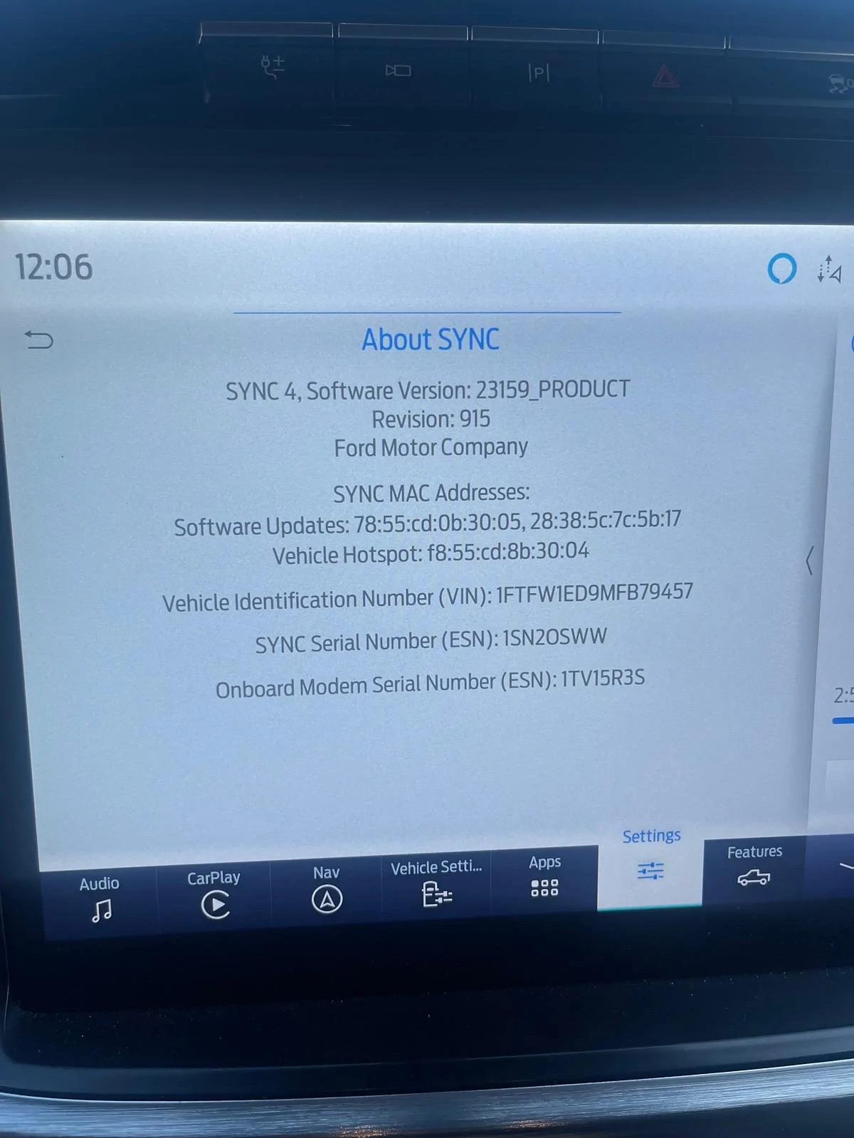

Looks to me like the did everything correctly. They updated the APIM, GWM and TCU several times after the new APIM was installed. Post a pic of the "about sync" screen on your truck to make sure a few things on there match up with what Ford has on their side, but it looks good to go for updates going forward.

HI Rugedraw, thank you very much for the check up! That's awesome news, been 3 years since any updates. Sure on the photo soon. Appreciate your help!!

Is this photo that you’re talking about Rugedraw?

Ok, so Sync version and APIM serial numbers match up, so looks good to go. PTS shows campaign 21G01 to activate BC is open on your truck. If your BC is still not functioning, the dealer can activate it for you now.

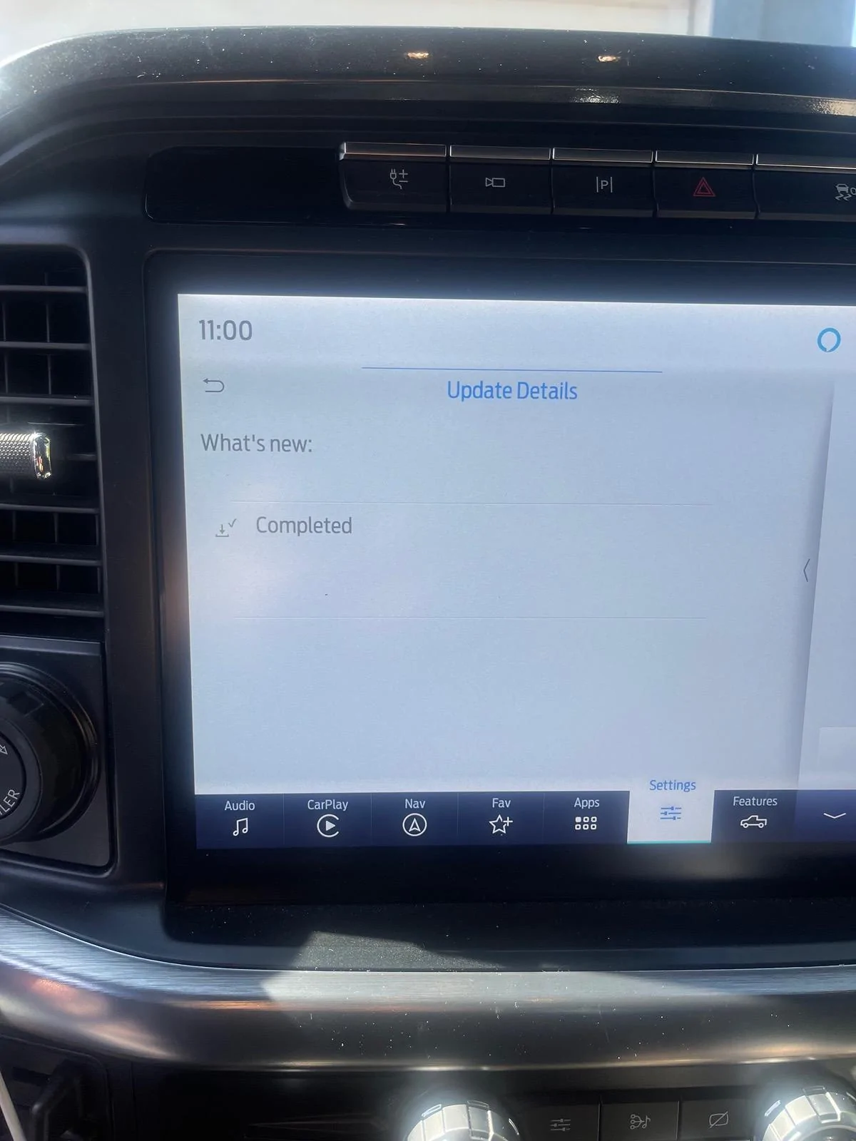

I took the truck in for some warranty work in March and asked the dealer to manually update all of the modules because the OTA process had yet to complete updates with the evidence of still being on Sync version 21008. When I received the truck back, I was assured the updates had been completed yet the Sync version remains the same. Would you please be willing to run the VIN again to determine what the dealer might have actually completed? Thank you!

They did nothing. They didn't even plug the truck into FDRS.
