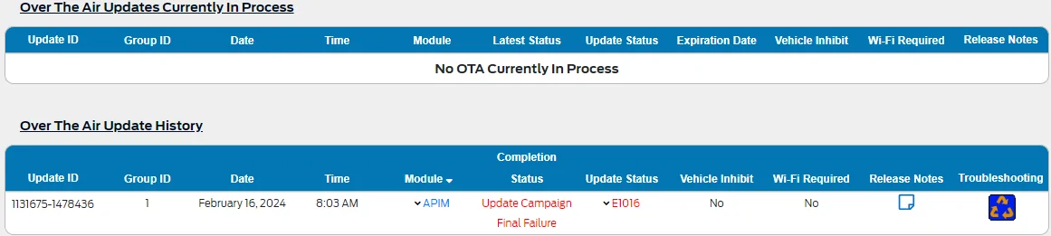

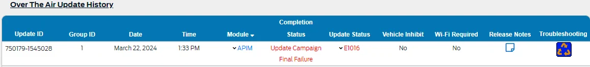

PTS is showing this update has failed all of last year and Jan of 24. I am no expert as to why it has failed. It might be from one or some of the outstanding updates shown about not being installed. One of the experts on this forum maybe able to answer that.
Ford F-150 Request VIN Lookup Thread 1711163456548-1
EDIT: I just looked a little deeper and did you just buy this truck in May of 23? It shows having 91 miles on it when bought. Because the truck was not started when the OTA was sent to it, that is probably why it failed to install.

I literally just got the truck 2 days ago. It was used a service vehicle at the dealership so technically I am the first owner. I know for sure it was never connected to the WiFi there. Thank you for info.
Can anyone offer some insight on how to get these updates kicked off. I did try the whole rebooting of the stereo, sending feedback to ford via the stereo and setup scheduled updates. Thank you again for all your help!

The OTA updates are in Fords hands. When you will get them and how fast is up to THE FORD GODS or MOTHERSHIP, as we call them. There is nothing you can do. Only thing I recommend that you get a battery maintainer and connect it to your truck. I believe alot of members use the NOCO 5 or 10 on their trucks. Ford says you need to be connected to WiFi. In 3 years I know of only 1 OTA that came WIFI. As long as you have good cell service they will come. Slowly.
With the number of updates you have, I suggest you go the buy/borrow Mongoose and a 2 day FDRS license route. You would also need a battery charger/powersupply. As I mentioned before, as these are installed, others may show up. It will be a marathon 2 days, but the truck will be so much better. The unfortunate part is that it is about a $600 investment on your part to buy the equipment.
Check out this thread. Many have gone this route. The dealer will not do it for you because Ford will not pay them to do the updates unless you have a problem. There are a lot of members here that will help you out and answer you questions. There might be someone near you that is willing to help you out. @rugedraw Has a site were he lends out the Mongoose adaptors.
Read the first page or two. Explains what is involved. At first it is overwhelming but FDRS steps you through the process. I was nervous at first, but after doing a few updates, my nervous went away.
