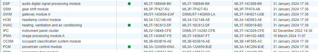

I was right; they didn't program the new APIM correctly. The good news is, our resident guru can fix it easily. This is what I need from you:
Turn on the truck and go to AM radio; which station doesn't matter. Hold the seek forward on the steering wheel and the radio controls below the screen down at the same until the speaker test pops up.
Then, scroll using the arrows on the steering wheel until you get to Apim Diagnostics.
Click that and then scroll to. Part numbers.
Get me a pic of that screen.

@OldMan1962
Here ya go! Thank you again!
Ok, everything is fixed on Ford's side now. You won't see anything different on your truck, but you're good to start getting updates now or update it yourself if you decide to take that route. You are now showing a GWM update available that wasn't there before, so to may get lucky and get your 1st OTA soon. There is no way to predict when an update will be sent to you, but the connection between your truck and Ford's servers is now officially fixed.

Can I get another VIN lookup on 1FTFW1RG2MFC61714? I did a full FDRS update a few months ago, but haven't received any OTA activity. I did notice my center cluster settings were reset the other day, and as well that I never reconfigured my WiFi settings but no indicated OTA activity sense the FDRS update. Mine's a Raptor with no BC, so perhaps that's why.
You only have these 3 showing in PTS
