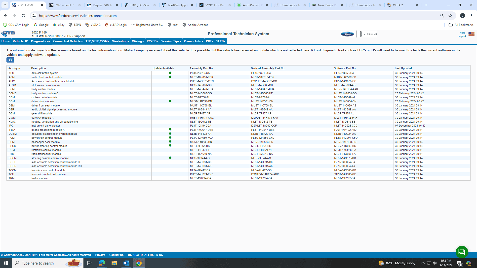

I can check FDRS for you later when I am home and have my laptop. In the meantime, this is what PTS is showing and there is an IPMA update showing which is good.
Thank You so much. I will wait if theres more detail which I can use.
How much time do you think Ill need to update all modules with updates?
Hard to say exactly. You're on the latest sync, but the IPMA will take 2.5-3 hours alone. Please note the PSCM and IPMA are chained together, so don't start either one unless you have the time to see it through. The rest of them are pretty quick. I would say 6 hours max unless more pop up with FDRS once you actually connect to the truck and it syncs up with the mothership.
