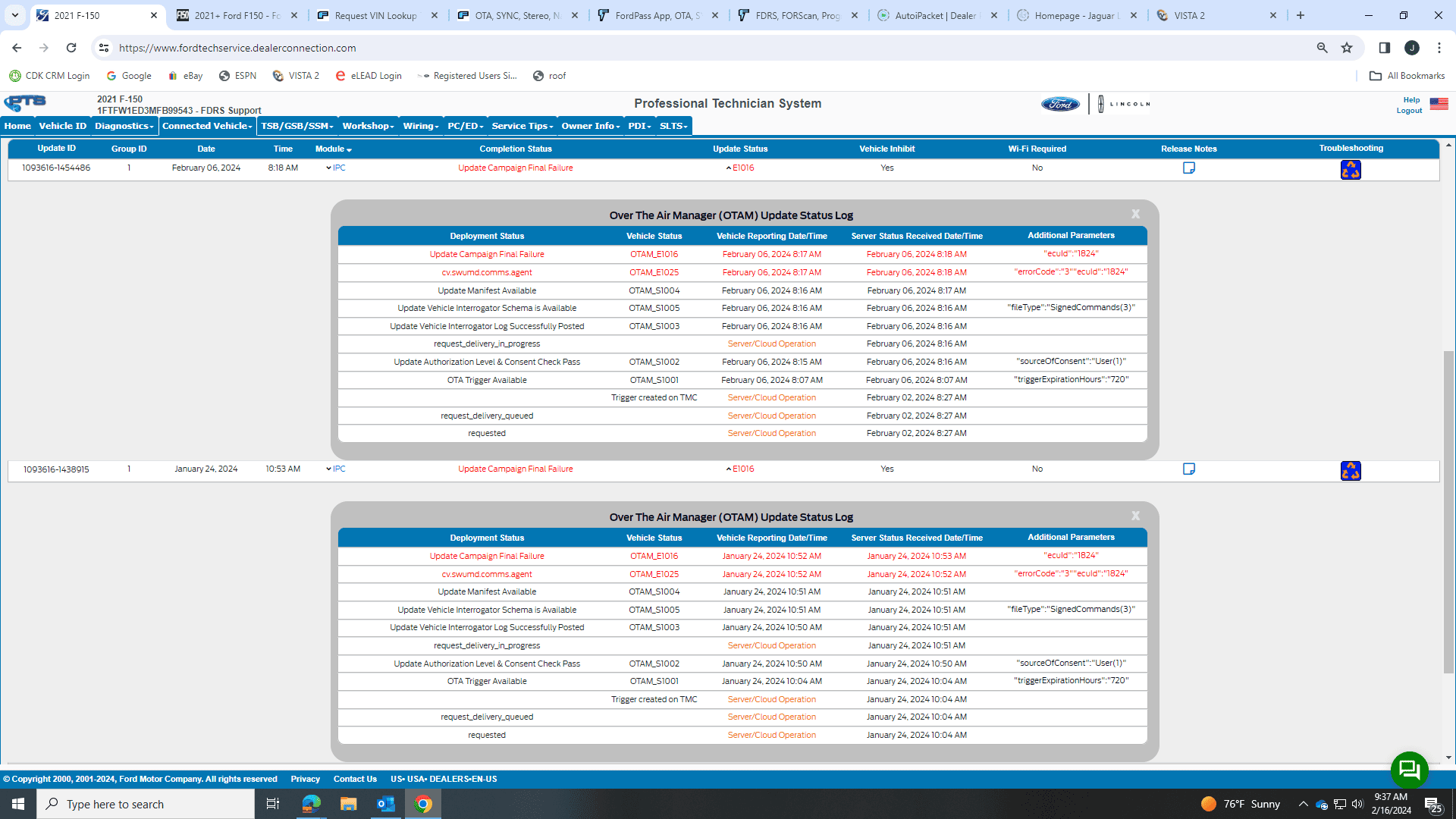

Hey there, Could someone please check my vin for updates? thanks in advance for your help!!
1FTFW1ED3MFB99543
I had an update show up in my app as failed last week....

IPC update 4.3.2 has been sent to you twice within the last month and failed both times due to whatever this error means. Hard to tell if the issue is on the server side or with your truck. That particular IPC update did not go through for me with the OTA process and I had to manually install it with FDRS.
Thank you for checking!

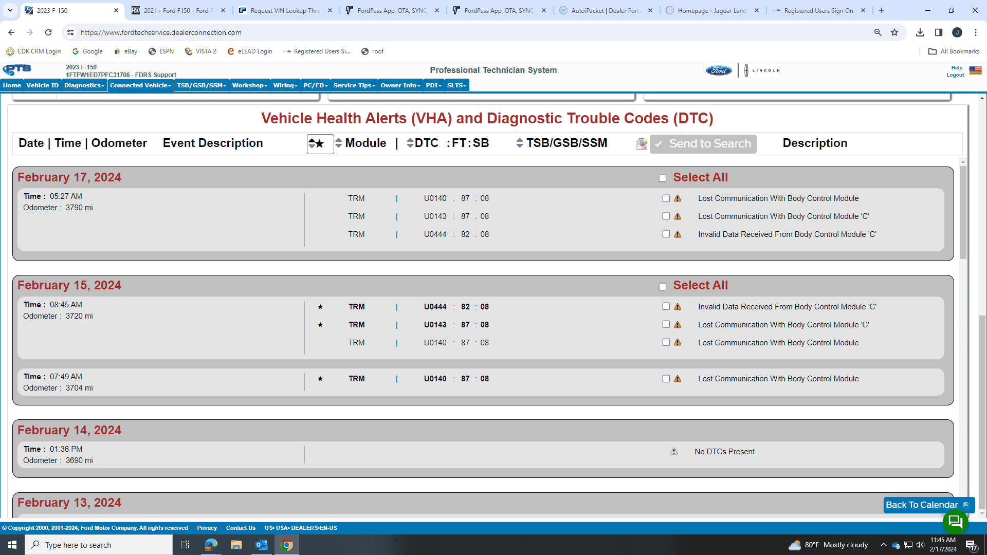

Hey Sorry to ask again, but is their anyway you can show what modules need updates for my VIN 1FTFW1ED7PFC31706. My dealer said they had to update the GWM to resolve my intermittent trailer brake assist fault messages, but after i got it back I have had a quick flicking message which i suspect is the same issue. Just curious if they did anything at all. If not wondering if its advantageous to run some module updates.
Thanks Again!
The did indeed update the GWM. Nothing else.
Unofficial list of modules pending updates is below. I don't have access to FDRS to provide the accurate list until later, but this will give you a good idea of what you have pending.
Ford F-150 Request VIN Lookup Thread 1708188249872
Your truck was reporting a corrupt software in the GWM that is now gone, but it is still reporting codes regarding the trailer module.
You are the best thank you again!
