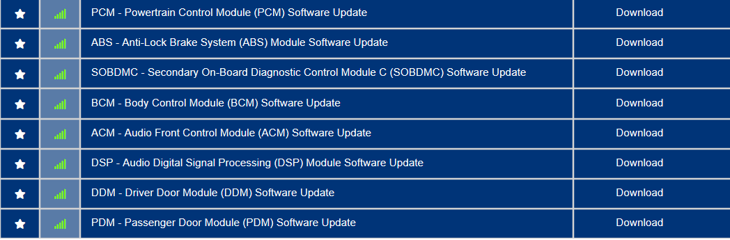

Hello.
Had my APIM replaced but still having issues. Is someone able to look up my VIN and see what updates are outstanding for all modules?
VIN: 1FTFW1E89NFB72075
Many thanks!
I see the APIM was replaced on 10/2 and the the PMI was done correctly from what I can see. Modules pending updates are below. What issues are you having?

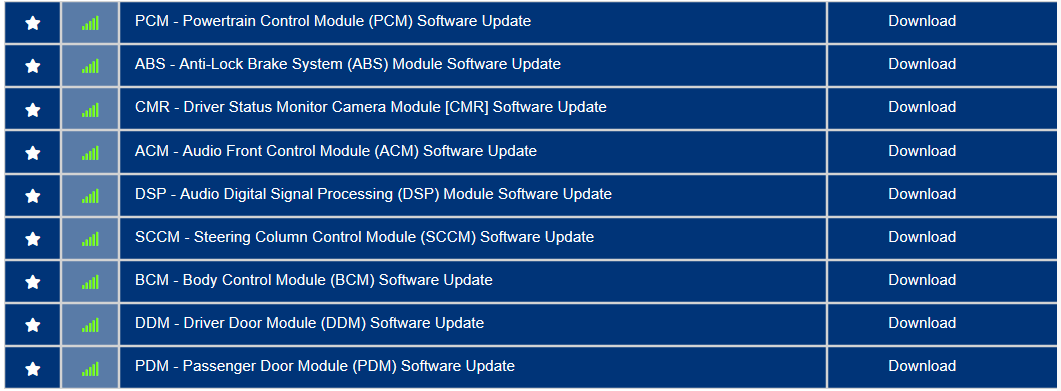

1FTFW1ED8MFA85585
Just looking for a look up please see if I need to hook up the Mongoose again.
Thanks in advance :cool: deciding whether or not to pay for 3 years of BlueCruise on a 2021 Platty with 52,000 miles
Modules pending updates are below. Hold off on FDRS. They started releasing the last bits of updates needed for BC 1.4 last night, but only for 2023 trucks. Save the $50 for when you are showing IPMA, PSCM and APIM updates.
The original issues were:
- Headlight system error
- turn signal sound not audible but signal flashed normal
- turn signal hyper flash inside, but outside regular
- sync not maintaining settings
- pressing fan speed down would initiate voice command prompt
- my view menu in instrument cluster reseting on its own
Now:
- the headlight system error has come back
- parking/front proximity sensor error eventhough nothing is impeding them
- my view menu reset itself again
Is there a way to tell if those pending updates were released after the APIM was replaced or if they were pending before that?

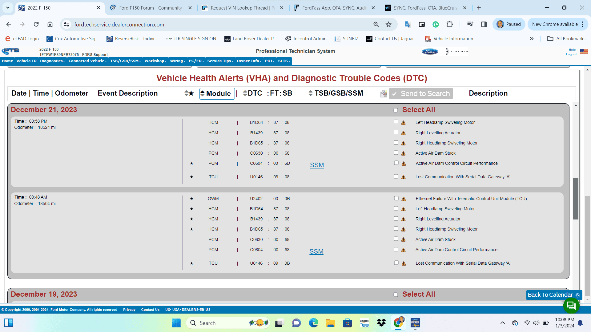

Now:
There is no way to go back to see what updates were available on a certain date. I don't have a good explanation for the issues you are having, but on 12/19 your truck started recording some headlight DTC's as seen below.
Sounds good. Many thanks for the help. I'll book it in with the dealer to get things looked at.
Thanks again!
