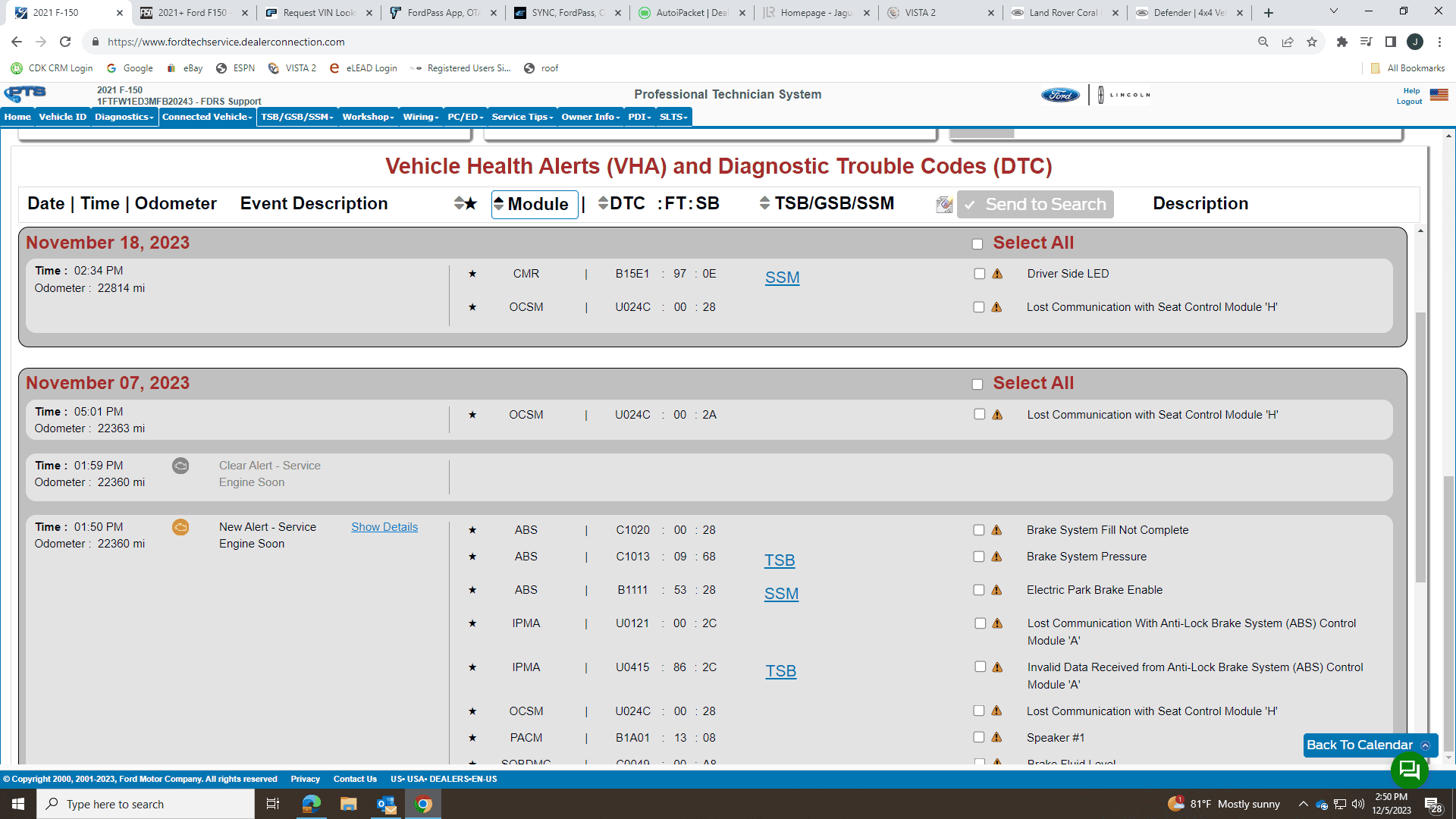

@rugedraw , would you mind as your time permits to have another look at my VIN., 1FTFW1ED3MFB20243. No issues with it as it has been running great but there will be codes for a lot of things but none that might need addressing as far as I can tell.
Much appreciated.
DTC history is clean except for an event it recorded on 11/7. Details on the event read:
Customer Communication: November 07, 2023 01:50 PM
What is happening?
Light Stays On: The On-board Diagnostics System has detected a problem with the engine, transmission or an emission-related component or system.
What should I do?
Refer to Instrument Cluster Warning Lamps in the Owner's Manual for information on temporary malfunctions that may not require vehicle service. Light stays on: The vehicle may still be drivable and not require towing. Light blinking: Drive in a moderate fashion (avoid heavy acceleration and deceleration) and contact your authorized dealer. WARNING: Under engine misfire conditions, excessive exhaust temperatures could damage the catalytic converter or other vehicle components.
It seems to have been an isolated incident. If it only happened once and your truck is fine since then, I would attribute it to a glitch in the matrix and move on.

@rugedraw Thanks. The truck was in the shop that day Nov. 7th for work on the brakes, oil change and tires, thus the one time glitch.
