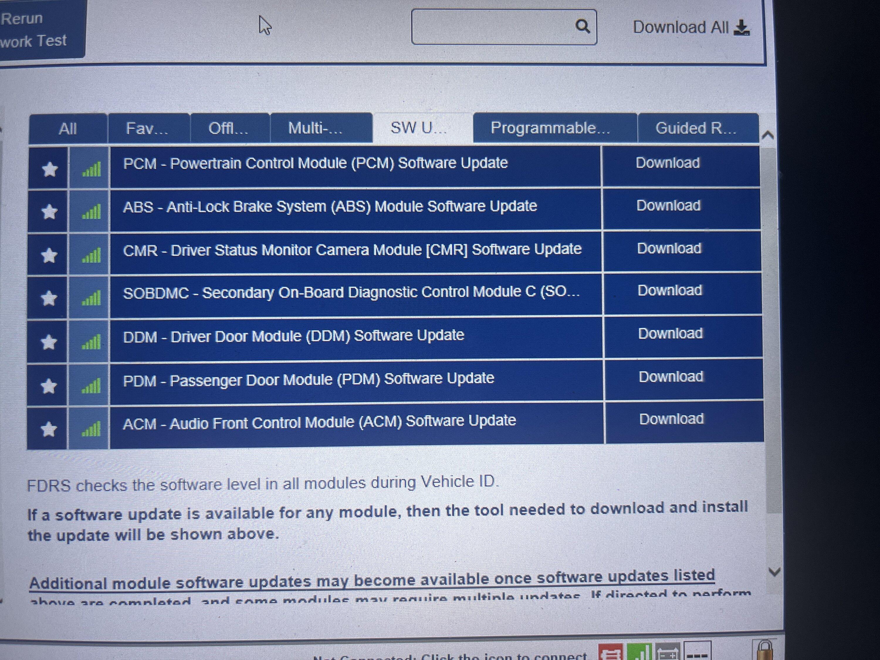

Would appreciate someone checking to see if I have any module updates available in FDRS. According to the app the last OTA update I have received is 6.1.0. Thanks.
