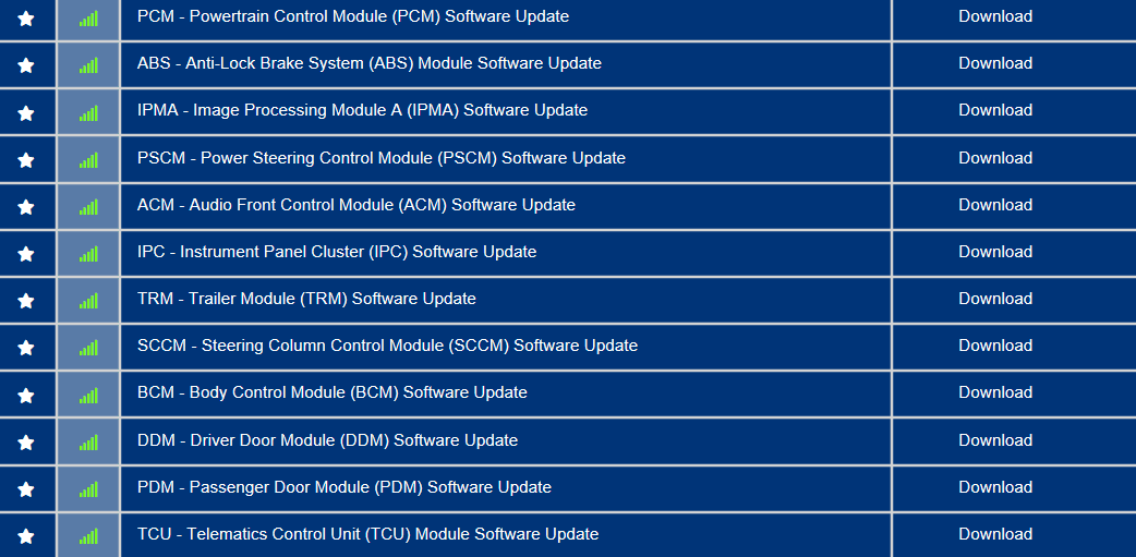

Need help again. Dealership has updated the APIM and says everything is updated but can't get the Blue Cruise to work. Truck is still at the dealership. Could someone check my VIN and verify that they have done some updates? VIN is 1FTFW1ED6MFB78296. Thanks

I know you don't know the answer, but have they tried driving the truck to see if it works? From what I can see, they updated every single module that can be updated on the truck to the most current level. I don't have access to FDRS now to see if there are any pending module updates, but it looks to me like all the modules than coincide with BC activation have been updated. After the performed all the module updates, they are trying to run the BC enabling program in FDRS and it keeps failing due to the Sync version being wrong. However, if all the modules are updated, the BC activation program should not be necessary.
Go to your Fordpass app and check connected services. What does it says under Bluecruise?

Under connected services ot states "coming soon". Thanks for the help.

I would message Jesse with your VIN and ask. From what I can see, you should be good to go, but with his tools and knowledge, he can see things I can't.

Picked up the truck, dealer said it wasn't working. Turned it on in the menu, and it works. Guess someone just needed to drive it....
