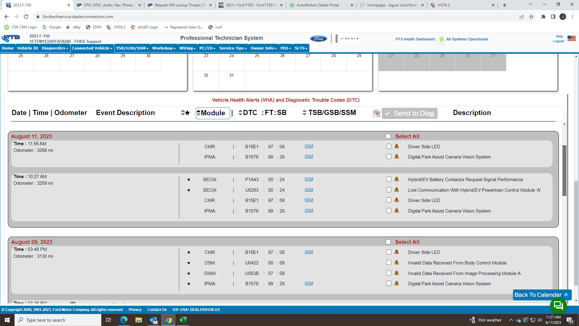

If I could get a VIN check as well I'd really appreciate it. I have 3300 miles on my truck so far so I'll head to the dealer for a 5k service soon and wouldn't mind knowing where I'm at with software. I'm having the dreaded issue with no starts / stop safely but it seems to be better now that I charge it once a week and keep HVAC on 5+. I'm having other little annoyance issues like settings changing automatically. My Sirius Sat radio keeps changing my presets and back seat occupant alert keeps turning itself on. Hoping some software update can at least address those while Ford works on the no start issue.

The codes causing the intermittent no start and stop issue are in the attached screenshot. P1A43 and U0293 are the culprits.
It's amazing to me you can see that and how far automotive technology has come. That's the main reason I give Ford some slack on this. I feel like this truck is a marvel of modern engineering, especially so coming from a 2011 F150.
Anything I can currently do about those codes other than what has already been discussed in the thread? Wait for Ford to release a fix? Just want to make sure I'm not missing something.
I am not a tech, so I am not sure, but if I had to guess, this requires a trip the dealer so they can diagnose what physical component is failing and causing these codes to appear.
