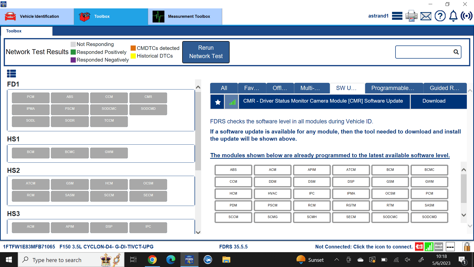

4.2.2 installed on 4/13; no OTA action since then.
1FTFW1E83MFB71065 What does FDRS say for me? Curious to see if the IPC update that coincides with 4.3.2 is there for me.
Ford F-150 Request VIN Lookup Thread 1683382735280

Interesting. I wonder if a network scan will cause it to pop up. I'm not rewarding Ford with another $50 to find out, though. lol
