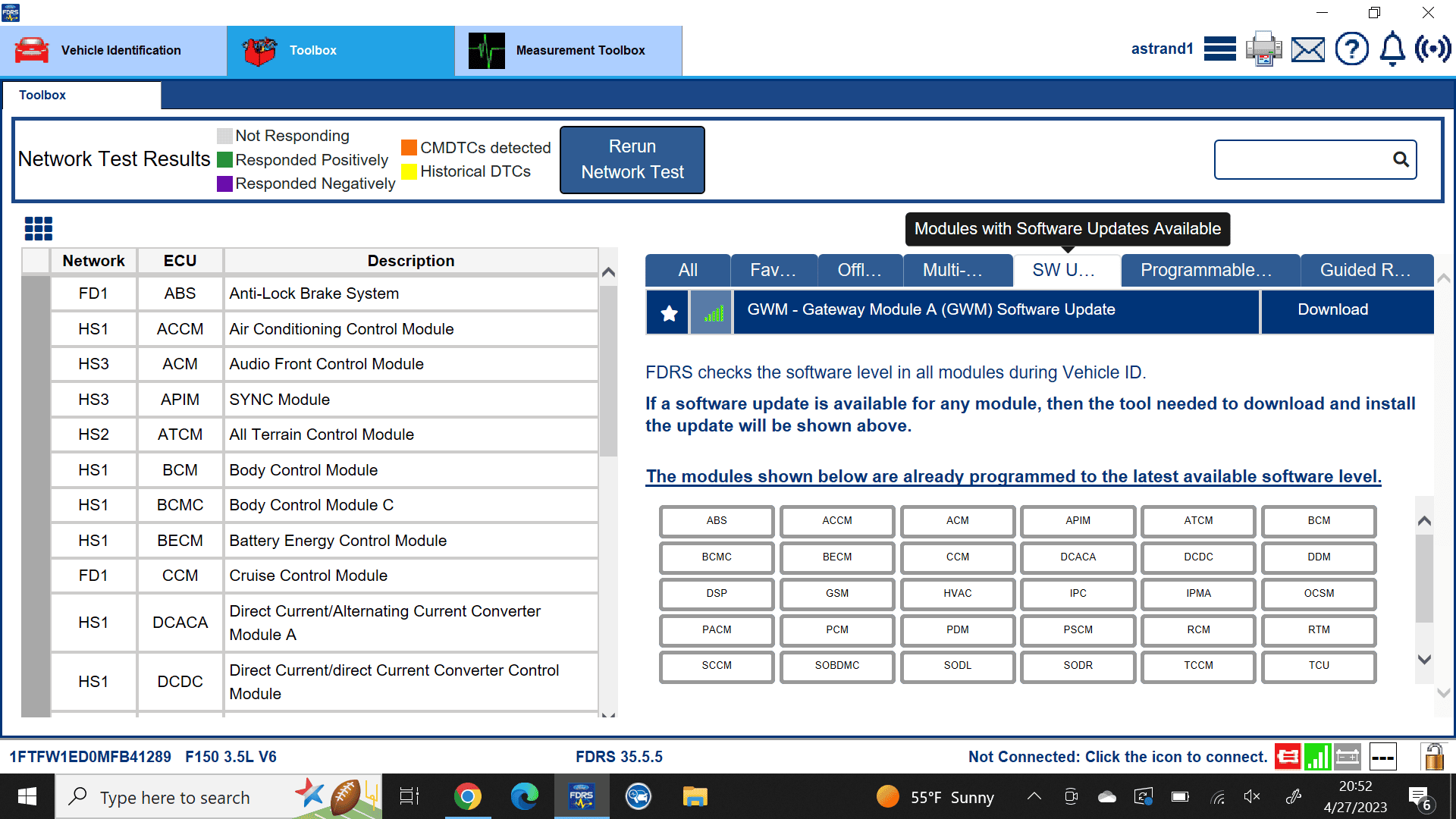

I think I got mine up to date via FDRS after never receiving any OTA. Could someone see where i stand?
1FTFW1ED0MFB41289
Thanks!
No. In fact in many cases updating via FDRS can fix the “link” and cause updates to start coming OTA. I just updated a guys truck last week. He had just gotten it although it had sat on the lot. No updates. We updated it and the next day he started getting OTA.Thanks!
I know this has been asked, but I don’t think I’ve seen a definitive answer: If I’ve updated via FDRS, will I receive updates via OTA going forward, or have I “broken the link”?
Great. So I should see that GWM update and whatever comes after via OTA?… assuming I can regain my patience with Ford.No. In fact in many cases updating via FDRS can fix the “link” and cause updates to start coming OTA. I just updated a guys truck last week. He had just gotten it although it had sat on the lot. No updates. We updated it and the next day he started getting OTA.
