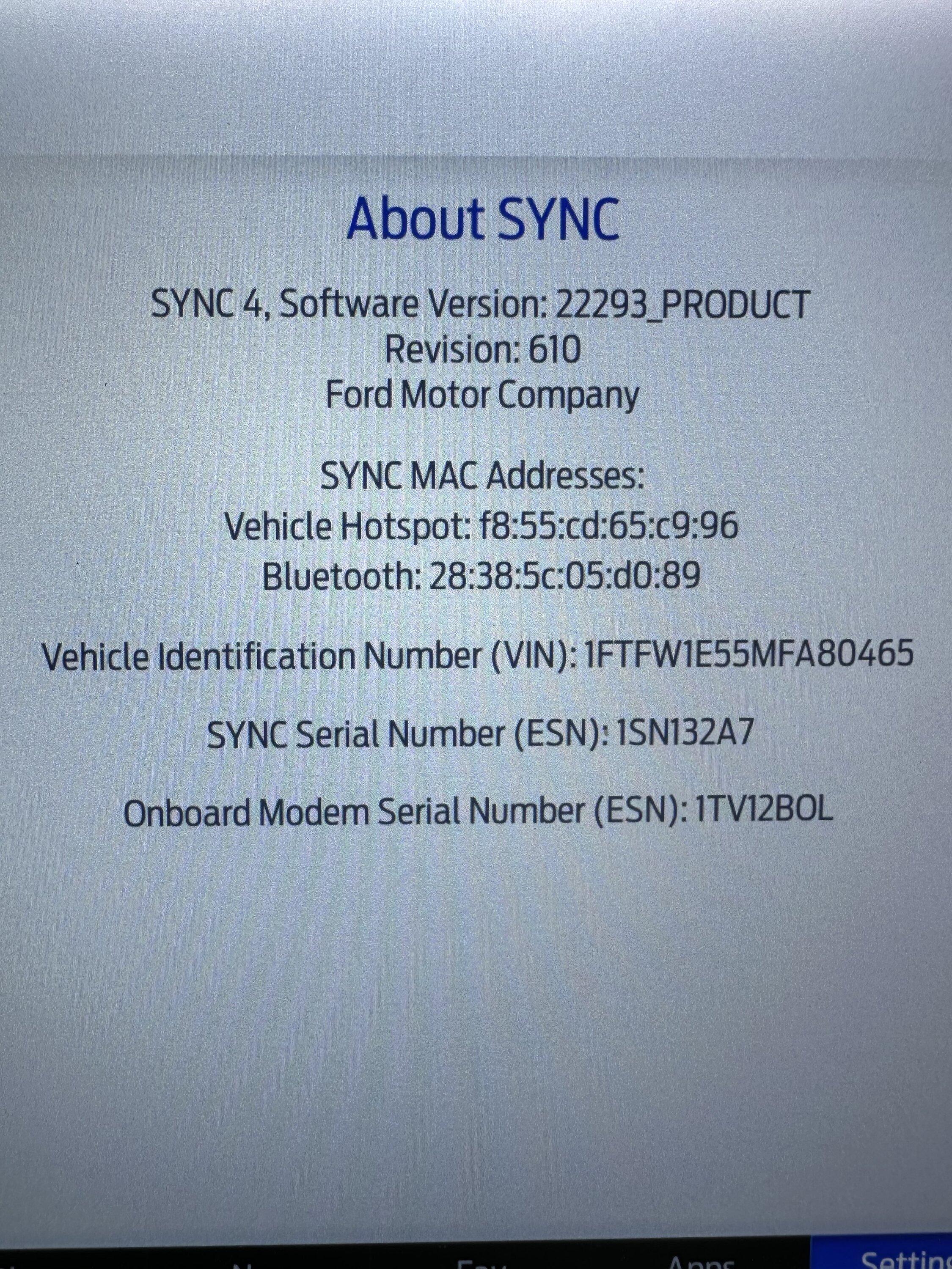

Can someone double check I am up to date? VIN# 1FTFW1E55MFA80465
Thanks!
Thanks!
You got 4.2.1 yesterday. Based on the rest of your recent OTA history, you are very close to being fully up to date as far as OTA updates goes.
