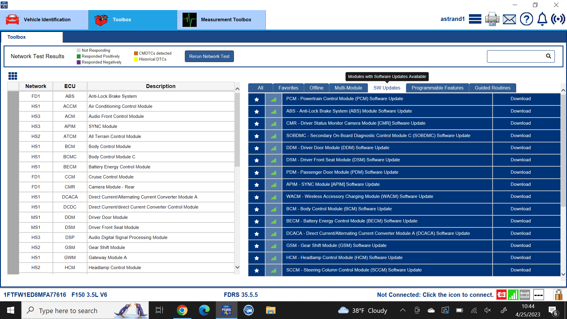

Ok time for me to use my own thread....
Would someone with PTS check to see if the latest round of OTA's are in the Q for my truck
1FTFW1E85MFA49677
you have 2 in FDRS.

Thanks, I figured I'd have some in FDRS as I haven't received any of the 4.X updates yet. Just going to wait it out and see what comes along
The CMR update is FDRS only, at least for now. It took almost two hours to complete when I did it. The only time Ford has updated the CMR via OTA was back with the 2.8.1 update for 2021 trucks, and we all know what a PITA that update was to go through with the vehicle inhibited for 2 hours while it installed and failing 90%+ of the time due to low battery voltage.

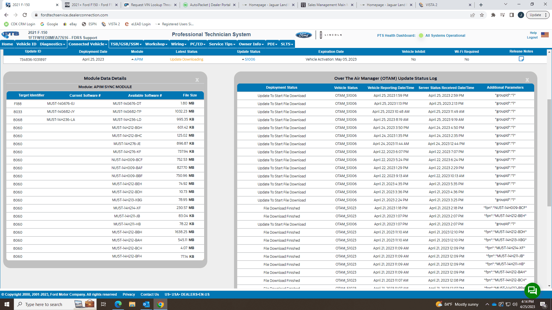

Would someone please check on 1FTFW1ED8MFA77616? When I turn off Automatic Updates and then check for updates, it shows 3.5.3 is "pending". It did the same thing back in January, and 3.5.3 never went through. Thanks!

Jesse was nice enough to check my truck's OTA status this morning. Do all of the files shown under the "Available Software" column, not just the ones also showing under the "Current Software" column, have to download as well? I had this 3.5.3 update pending in January, and it never completed, so now I am concerned about this time going through.
VIN: 1FTFW1ED8MFA77616
Those aren't the files being downloaded. That is the destinations to where the files are being download to. What you want to see in on the other side as per the screenshot below. It seems to be stuck trying to download a file which is a very common problem with this particular update and once this starts to happen, the trend is that it usually fails to install. The OTA trigger was created 4/21, so you still have 10 days for your truck to try and get the file. Good luck, but based on what I have seen, I would not have high hopes for it to go through if it hasn't already.
