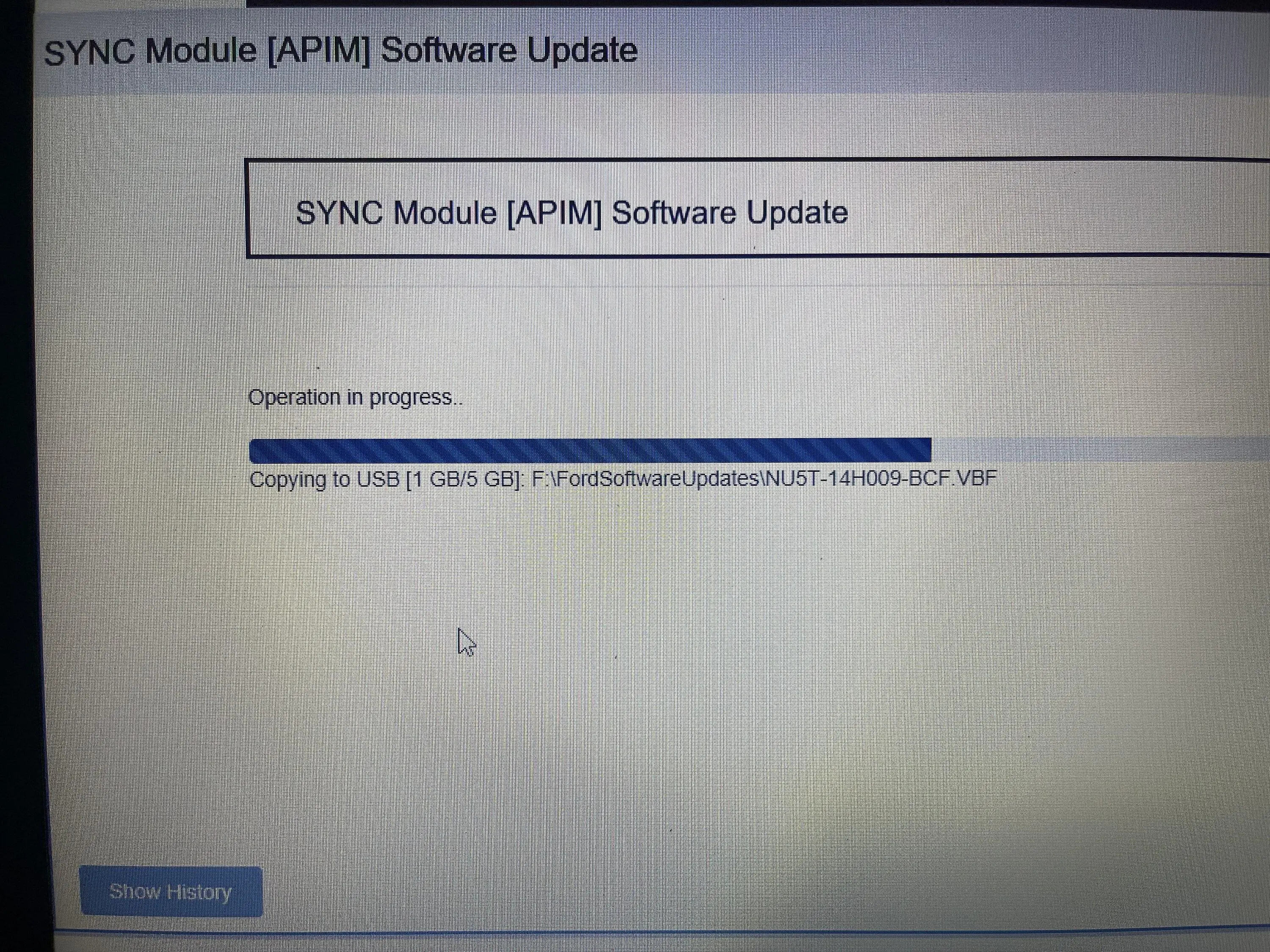

12 outta 13 updates updates done and now the final one. Mongoose cost a pretty penny. Just hope it’s worth it @rugedraw @pavementends
That's 3.5.3. When you're done with that, a TCU update will appear that will be the equivalent of 3.5.4. You'll be up to date after that. For now. Lol
Does that take a long time. This one is taking forever.

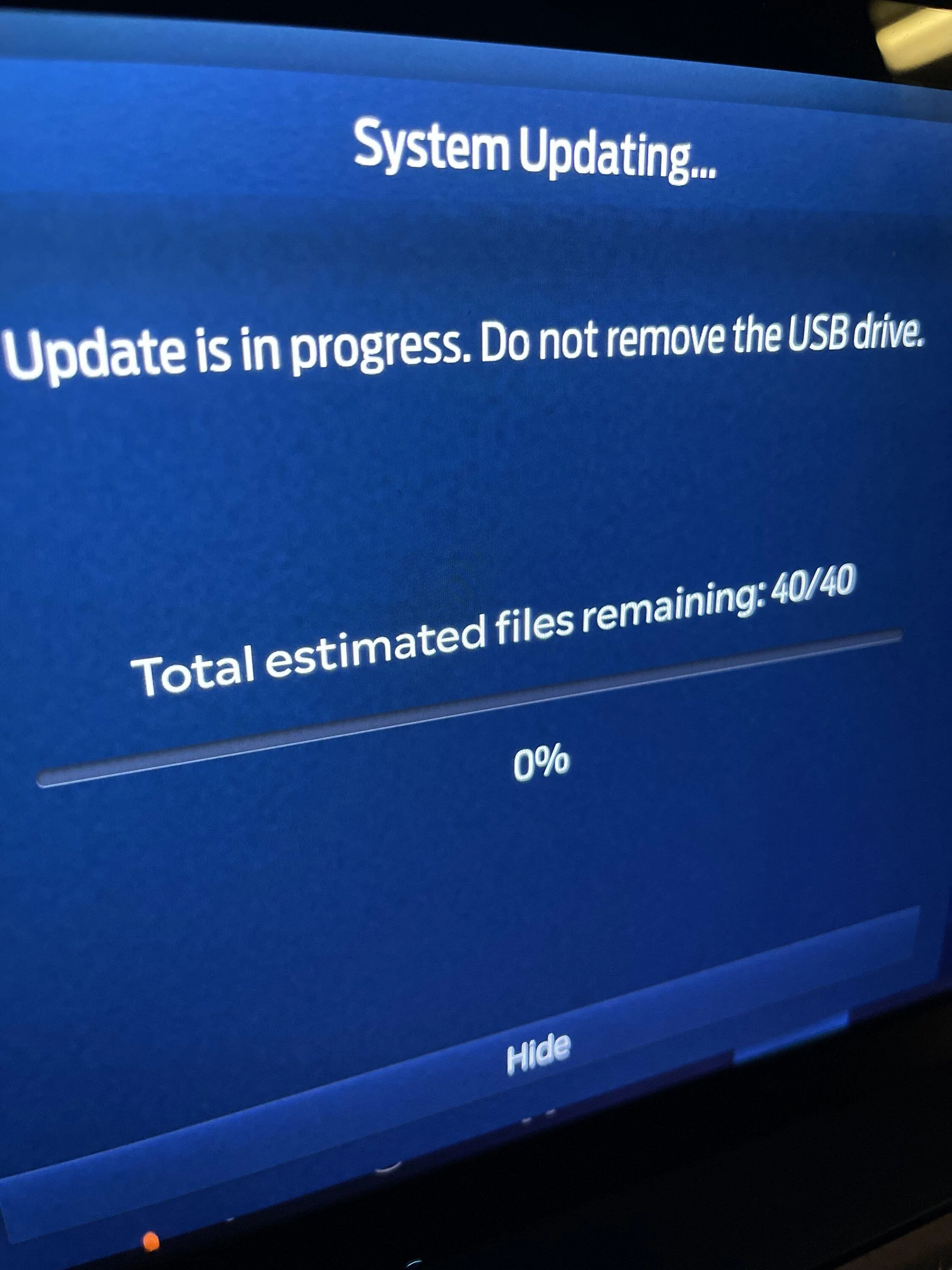

No where near as long as that one. It is also a USB update. When I did it the TCU one, the screen never said the update was successful, but it went through anyway. Make sure you click yes on FDRS even if you don't see anything happen on your touch screen. I waited 10 minutes instead of 5.
@rugedraw
Hey bud. How long after you put the usb under the AC controls does it take to install 3.5.3 ? How many hours?

@rugedraw its been like this for over 20 minutes now ? Any suggestions?
UPDATE: okay so as it had that screen, I noticed that it never moved. I decided to just turn the truck off. Go to bed and leave the usb in the truck. When I woke up this morning to turn on my truck I got a message that I may remove my USB. The update worked and all is right an just
! Couldnt have done it with the helpful guys in this forum.
