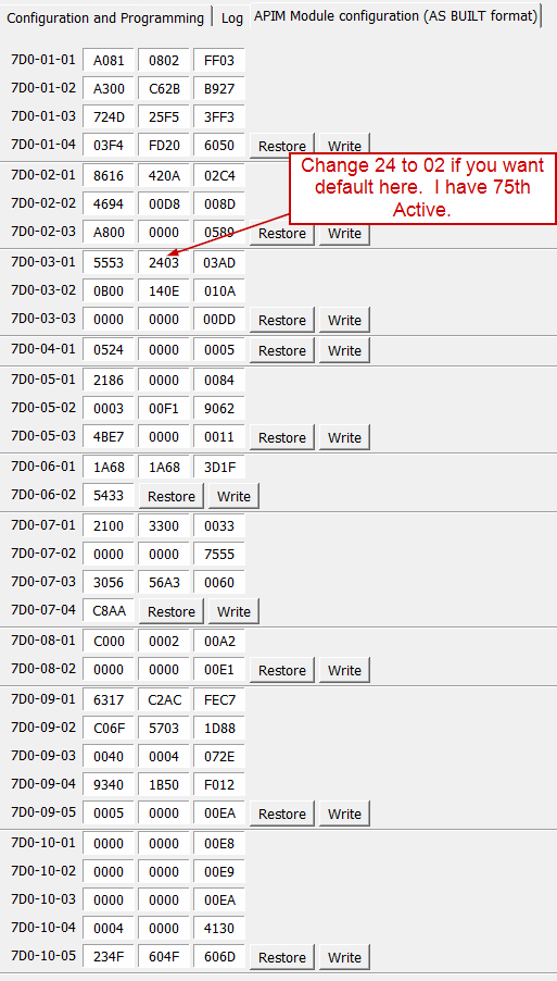

That’s exactly what I was thinking. Someone else’s original numbers should be the same as what mine were? If you’d share your values prior to the Unreal theme mod, I’d be forever grateful. As you said…the climate stuff etc would have to come from someone else but I believe they only work with the Unreal theme anyway?
Edit: OK sorry, I just got back from daughters dance recital, looks like you are good to go. Good group of guys here!
So, one further step I do, beyond the backup prior to change is I actually mark each code in my Livnitup spreadsheet. Really nice to just go back and do a manual change if needed.
Ford F-150 Remove Unreal Sync Theme 1702610438010
Ok what ya need just the APIM Screen?
Here is my snapshot of my screen. Everything APIM related is default except I do have 75th Anniversary enabled.
So the default on that is:
7D0-03-01 xxxx 02xx xx--
Now with THAT said, BACKUP what you currently have in case you make it worse...
Ford F-150 Remove Unreal Sync Theme 1702609985258
This is great. Thank you!!
