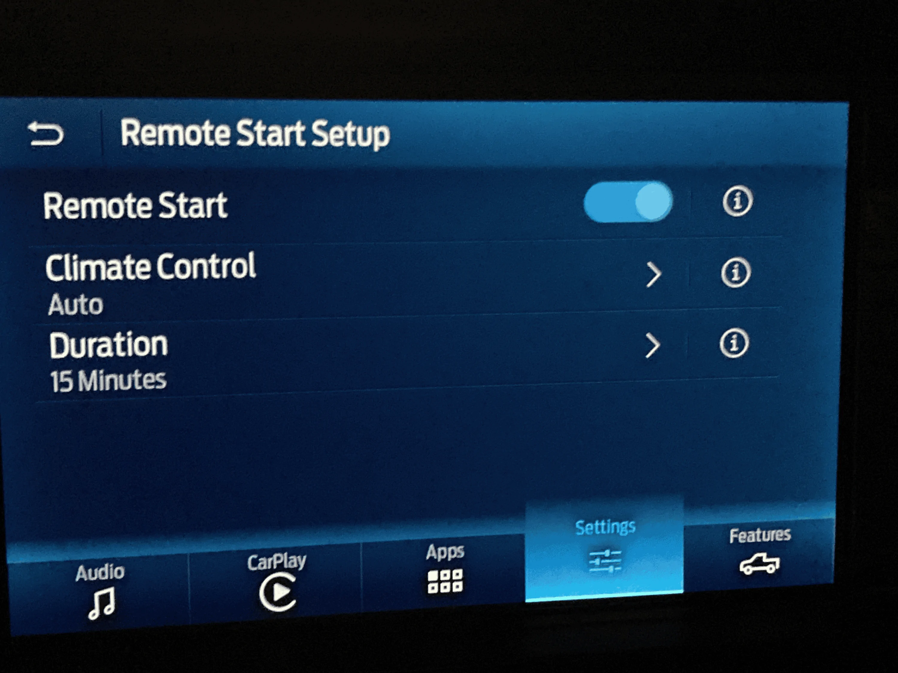

I want something I can control without the phone app. It sometimes lags, and I'd like to be able to instantly start my truck with the auto climate on and get in a few minutes later more comfortable. I was going to buy this product, but then I read that ford has one that is cheaper and OEM. Is this accurate? Is this all I would need? Or do I also need the "perimeter plus security system for $220?". https://accessories.ford.com/products/long-range-remote-start-system
vs
https://www.amazon.com/Start-X-Remo...09GNKJLKV/ref=cm_cr_arp_d_product_top?ie=UTF8
Any opinions?
I do have this in my menu, no clue if this means I only need the FOB or I still need that perimeter plus system.

If you are able to remote start via the Ford pass app then I see no reason why this wouldn't work. Your truck clearly has the hardware needed to do a remote start, it's just a Metter of programming that fob to your truck. I'd bet anything it has to he done at a Ford dealership. I'd probably check with them prior to ordering since it's non refundable.
