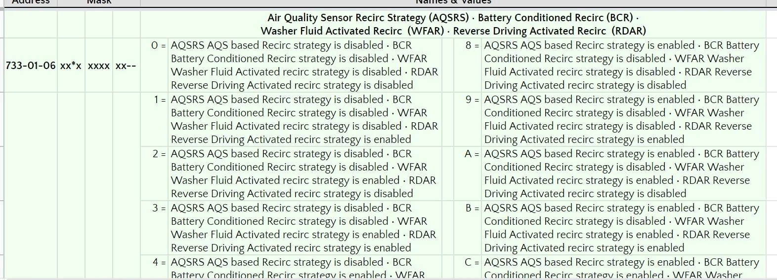

There are settings in the HVAC module that are specific to recirc cycles/strategies. They have names like 'cabin air refresh strategy' and 'air quality sensor recirc strategy'. It seems these settings can be changed via FORScan to alter the behavior of the recirc button. I haven't yet heard of anyone trying these changes, though.
They're on the HVAC tab in the 2021 F150 FORScan spreadsheet:
https://
docs.google.com/spreadsheets/d/1-_e09lLPPeSHoO3SsNwyqu5v3dgpbluvJcezUItTSVI/
e.g.,
I’ve tried probably all of these with no luck. And the defog strategy mentioned below. It seems most of these strategies are connected to “auto” mode. Manual mode still times out at exactly 5 min every time.

Give this a try:
HVAC
733-01-07 xxxx x8xx xx (If OEM is A)
This disables the “Enhanced Windshield Anti Fogging Strategy” which is the primary cause of the recirculation turning off.
