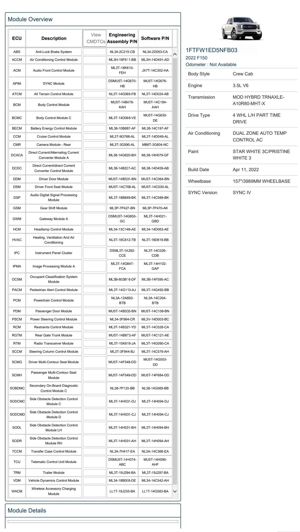

Just cancelled appt for tomorrow. No reason to reschedule until the dust settles on this chaos.
I did the same thing with my appt scheduled for today.
My newest truck was built 10 days ago (4/11) and is currently in a railcar somewhere heading south. So it's about as fresh as they come.
The TRM module is not DH. Lol
And even funnier is FDRS already has a TRM update available for the VIN, yet the update isn't DH either. (It's BB)
That's pretty strong evidence that either the fix isn't available, or DH isn't necessarily the magic cure.
Ford F-150 Recall: REPROGRAM INTEGRATED TRAILER RELAY MODULE (Campaign/NHTSA#
22S17/22v193) Screenshot_20220421-221837_OneDriv
