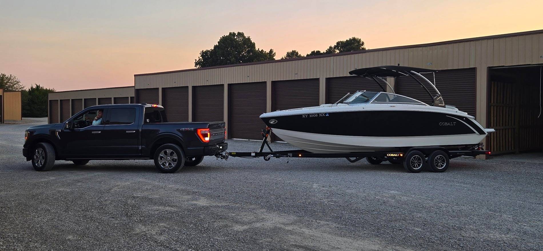

23 Platinum ,3.5, Max Tow package 5100 Bilstein upgrade all around with 2.5” strut plevel. Truck rides like a dream when not towing “But” when towing the rear end sags somewhat. About 2-3” with about 2-300# tongue weight. Would like to fix this issue without effecting the ride when I’m not pulling my boat trailer. What are some good real options? Let’s hear from the experts. thx for your time.

I pull a ~5000lb travel trailer with around 600lb on the tongue. I have a 2" level on the truck and with a combination of a WDH and airbags I can keep the truck with a slight rake even when towing.
I went with the Readylift Logiq bags due to their longer travel. With them at their minimum inflation they add about .5" of rear height but the ride feels no different than stock.
