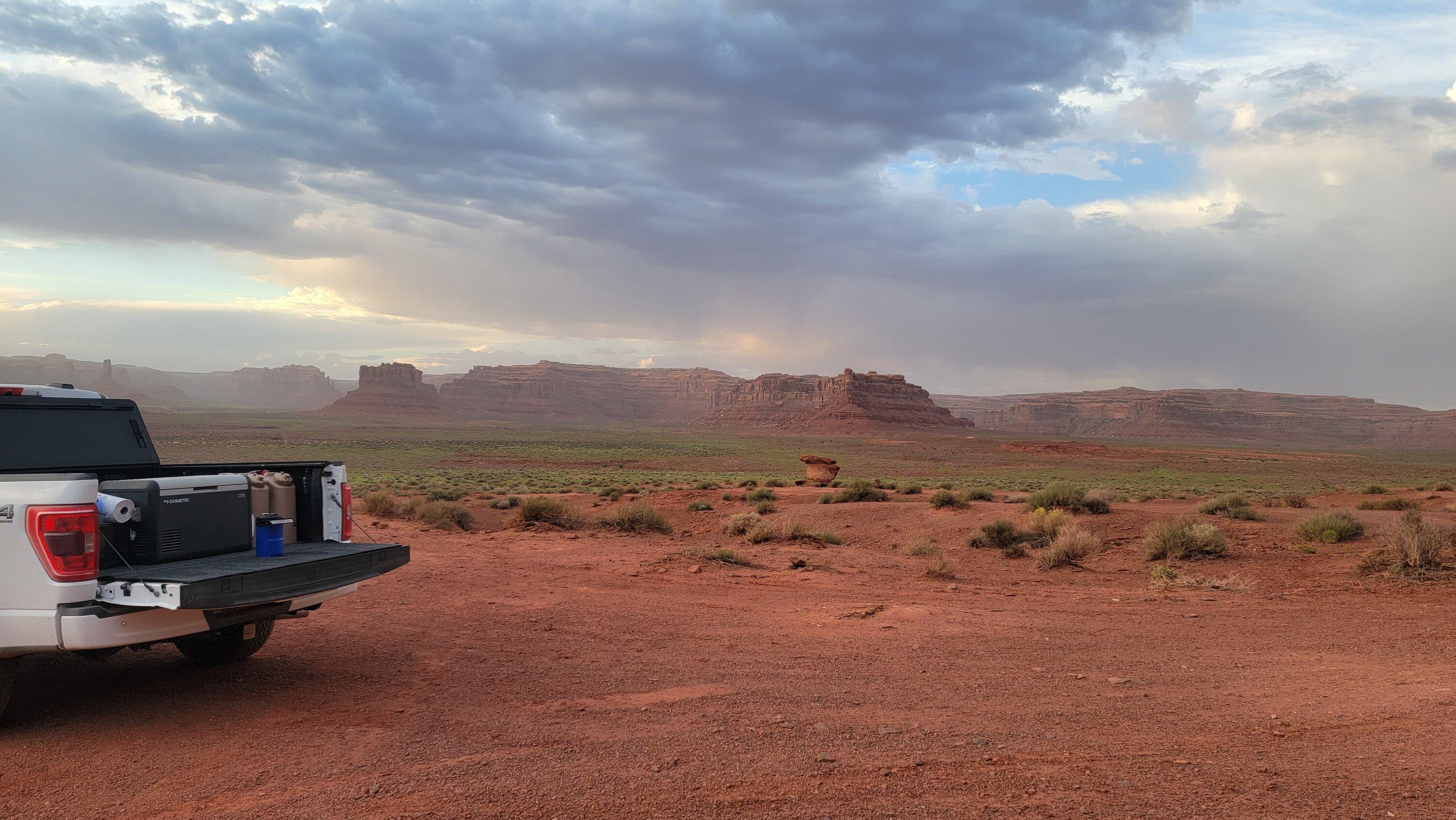

A mini fridge doesn't take much power, but leaving a truck running on/off all through a night or if I am away from the truck for a while is not something I like doing.
I plug my Dometic CFX3 55IM fridge into a Jackery 300 portable power station and then power the jackery with my truck. That way when I am driving the jackery is being recharged and when I stop the fridge will run off the jackery for about 20 hours if the weather isn't too hot. Truck Outlet --->Jackery --->Fridge
The really great thing about the powerboost for me is that I can take a microwave oven with me on road trips. That has to be directly powered by the truck because a microwave ovens need lots of amps.

Really cool setup! I may have to do something like that. Have you had issues with Jackery or Dometic overheating under the bedcover?

Interesting question. There was one day last July when I was driving through the Badlands where the outside temperature was extremely hot and reached 114 degrees. It was the hottest day of the year. I was very surprised the fridge still operated. However, I can tell you that my jackery battery stopped operating at about 105-107 degrees outside. So I plugged my fridge directly in to the truck outlet until later in the day when the temperature dropped. Everything worked fine after the temperature dropped and beer was still cold.

Although I don't have a PB, I agree with Str8Shooter on this, very low power draw from a decent fridge. I am happy with a portable solar gen like a Jackery or in my case a Bluetti. I Overland for 7-14 days at a time and in all climates and environments and have had great success using my ICECO fridge/freezer. I keep mine inside the cab (SCREW) since my seats are always folded up. I use the trucks 400w plug when driving and the Bluetti takes over when camped or stopped thru the DC plug. The ICECO automatically switches between AC and DC draw when the truck starts or shuts down and the little Bluetti recharges when the truck is running and could run the fridge when stationary for about 36ish hrs. I also use a portable solar panel when stationary for more than a day or so. For the price of the small Solar gen, IMO it's worth it and probably better then having to go through your truck starting, idling, and stopping throughout the night when camping.
...and having cold beer and a steak in 105 degree temps in the middle of the desert is more than a morale booster.
Ford F-150 ProPower MiniFridge 20230129_090136
Ford F-150 ProPower MiniFridge 20230129_090227
