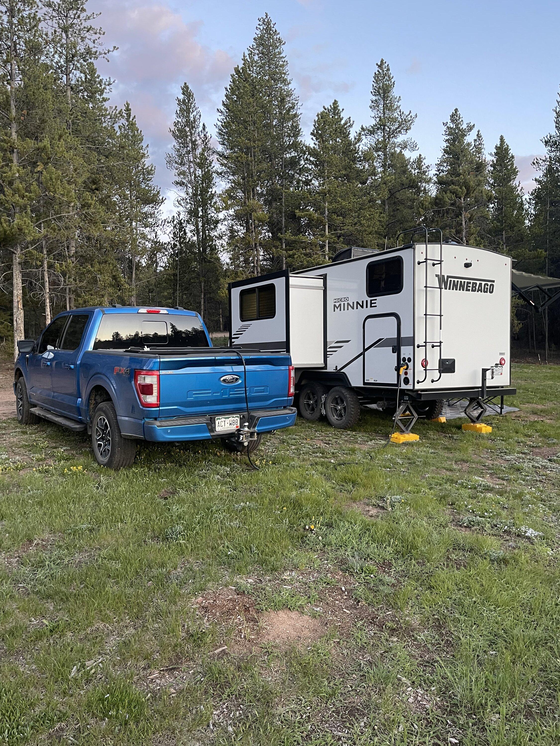

I’m disappointed some of you have not been able to have the same success I’ve had running my 30amp trailer with the 7.2Kw (actually two 3600w) inverter. I will say the comment about engine noise to be unfounded. We’ve camped near tent campers and I’ve asked if they heard our engine kick on at night and they denied even hearing it. Not sure why some of you have experienced an every nine minute cycle of the engine kicking on. That has not been my experience.. Anyway, here’s some pics from our last trip up to Taylor Park CO.

I have lugged gas cans and generators all over the continental US. The Powerboost is a magnificent generator in versatility, efficiency, sound, and convenience. Not to mention with OBDLink app I can monitor it in incredible granularity.
It's true with the 30Amp RV, it's a clever approach to use 3600 watts on the standard RV receptacle and then use the other bank with an extension cord for anything that might tax the RV.
Admittedly, if I was camping in a situation where even the truck idling would bother others, I'd have to invest in an appropriate battery storage device. Afterall, a generator, regardless of how quiet it might be, has to make some noise generating.
I might be tent camping on the beach tonight. With the steady coastal breeze and waves, nobody can hear the truck idle. So that's a good scenario for this dream machine.

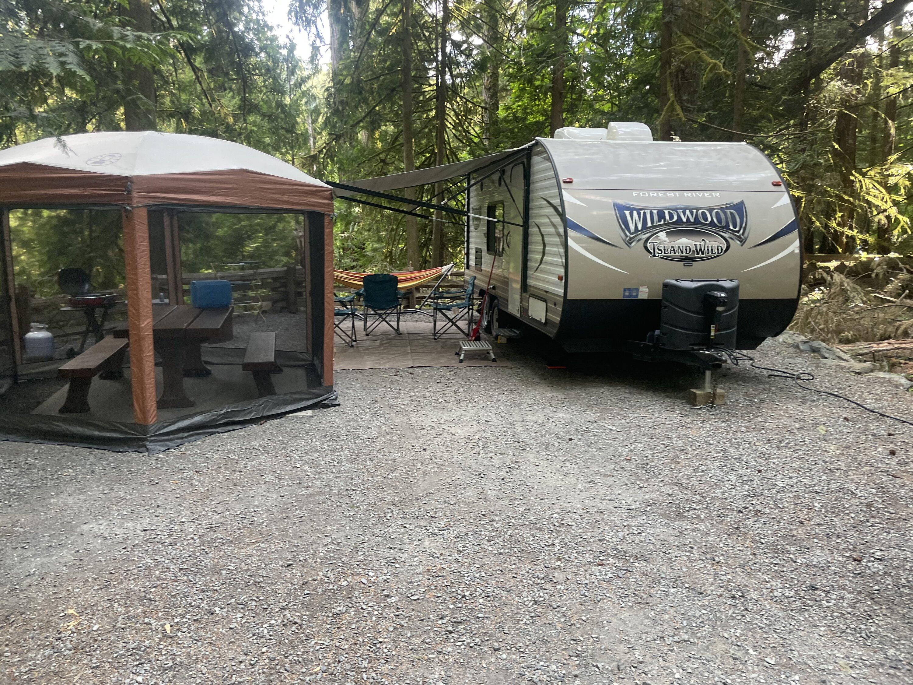

I’ve now been camping for 3 days using the truck to power the RV, without AC, so mainly lights and the occasional hood fan and the toaster. It’s been flawless outside of the weird “permanent idle” situation, but turning the truck off for an hour or so seems to fix that situation.
I’ve brought 2 electric scooters with us and they are amazing to get around the campsite on, so using the exterior 120v plugs to charge them overnight is awesome!
I will eventually try a soft start for the AC and see if it’s possible to run, but 99% of my camping is “glamping with hookups” so I’m not in a big rush.
My neighbours are perhaps 50ft away on either side and the only comment I’ve had is how quiet the truck is. One asked if it was running when it was.
Due to my low power draw, the truck idles about 2mins per 80 mins (roughly).
I am running my fridge on propane since I’m pretty sure it’ll be cheaper that way than the trucks genny and it’s more efficient if it gets hot outside.
I am kinda wishy washy on whether lacking the 7.2 is going to ever be an issue for me. I chose to go with the standard 2.4.
If there is a power outage I’m likely just to use the 2.4 for the fridge and my deep freeze, just so I don’t lose $$$ in food. Maybe charge a phone or two.

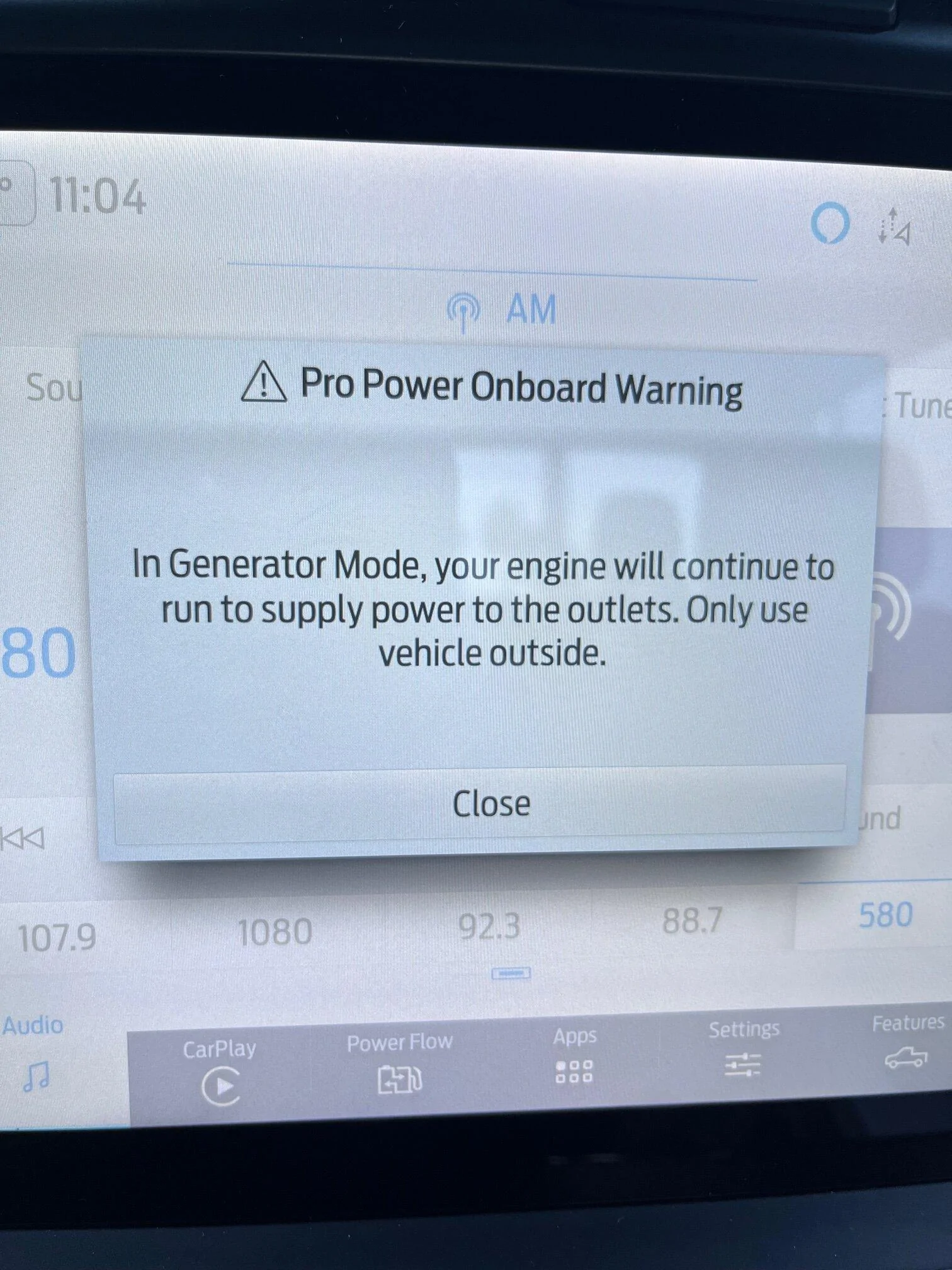

SORRY let me correct myself, it said engine running
It probably said this:
Ford F-150 ProPower and engine running full time for RV use or any use generator
That's a warning so people don't use it in their garages. Ford doesn't nitpick over SOC or load. Just expect the engine to be running and act accordingly so you don't go night night and never wake up. Carbon Monoxide is real.
