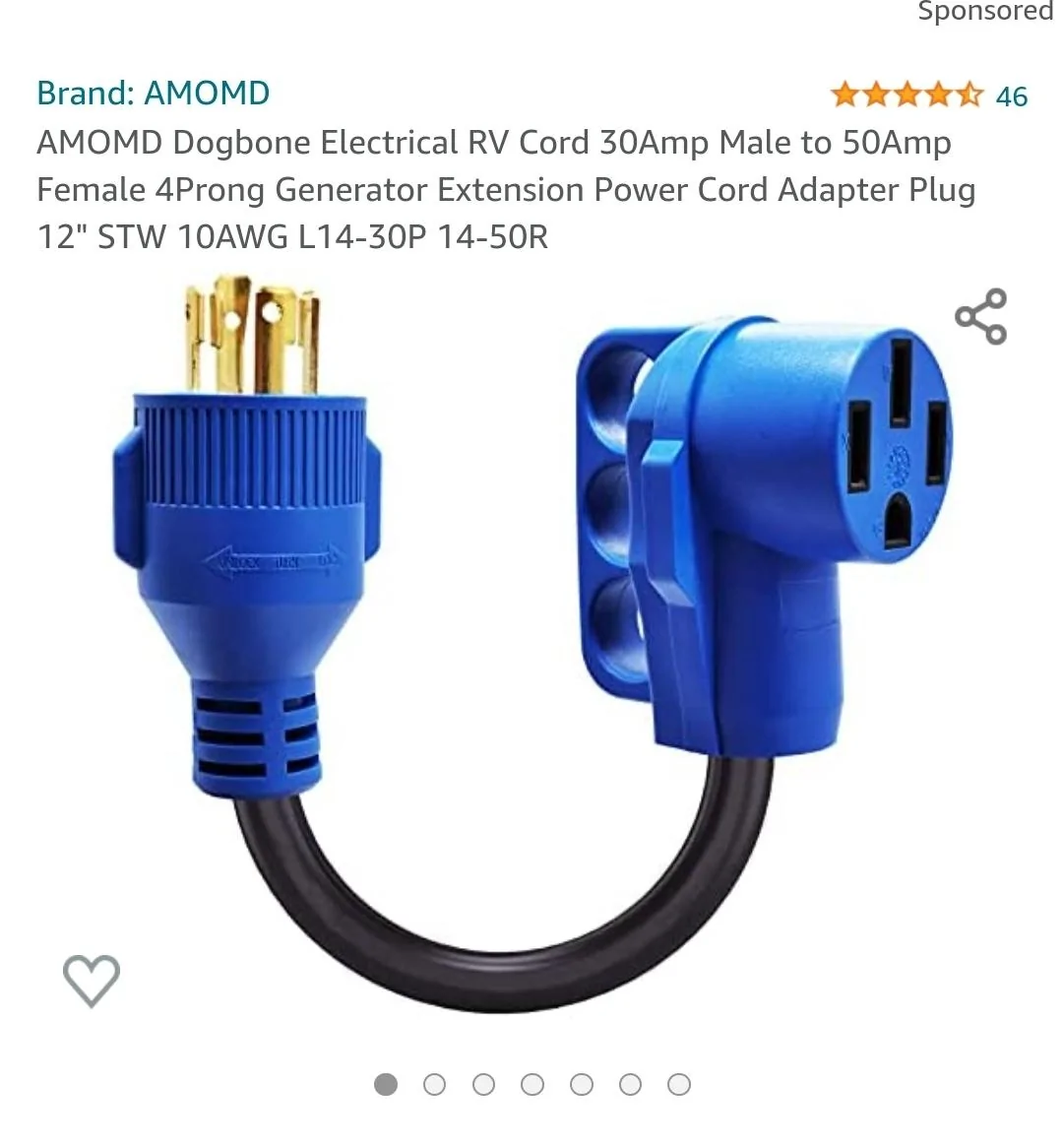

AMOMD Dogbone Electrical RV Cord 30Amp Male to 50Amp Female 4Prong Generator Extension Power Cord Adapter Plug 12" STW 10AWG L14-30P 14-50R https://a.co/d/gN61MNo

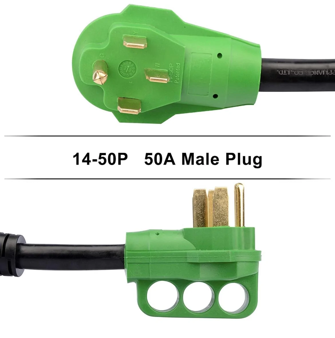

So these are the wrong plugs for ProPower to 30 amp Trailer?
That looks like an RV50A male to two RV 30A female.
I don't know why you couldn't plug that into a ProPower L14-30P to RV 50A adapter?
I've done exactly that on several occasions using what I pictured earlier on the tailgate of my truck.
Sorry, I assumed you had your truck, already.
Here is the pic of the ProPower 240V/30A (but also 2 x 120V/30A) connector.
It is a NEMA L14-30R female socket.
The connectors are Gnd, Neutral, 120VAC and 120VAC. You can use it as 240VAC if you are driving 240V loads.

The adapter you saw above wasn't intended to be plugged directly into ProPower. Instead it was a typical dongle that some RV'ers have in their arsenal in case they get a camping spot that the 30A RV outlet doesn't work or doesn't exist. It allows them to adapt the RV 50A outlet to 1 or 2 RV 30A outlets
The other adapter, that does plug into the ProPower L14-30 outlet, would be plugged in first. It adapts the 2 ProPower 120V banks into a traditional RV 50A outlet.
There's a lot of options for RV'ers and the 7.2KW ProPower system. A boondocking dream machine.

Ok,
I understand now - I hadn’t looked at the actual Pins in details, this makes sense.
Thanks for the help and advice on this

While it would be nice if it were a little more stout, keep in mind that it's not very long. I'm no electrician but I don't think at that short of length that it would typically be an issue.
But dang that Canadian price is painful! At that price it SHOULD have more copper!
