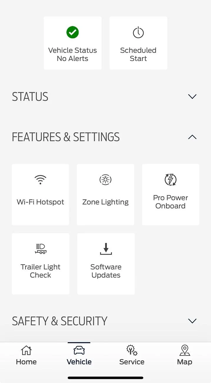

Do I have an old version? I just tested my zone lighting and it worked. I’m hoping I’m missing something since I just ordered a micro air soft start for HVAC and plan to be able to power the house when needed. Stay safe everyone!

That’s the old version. Don’t “update” it whatever you do!! Stay far away!!

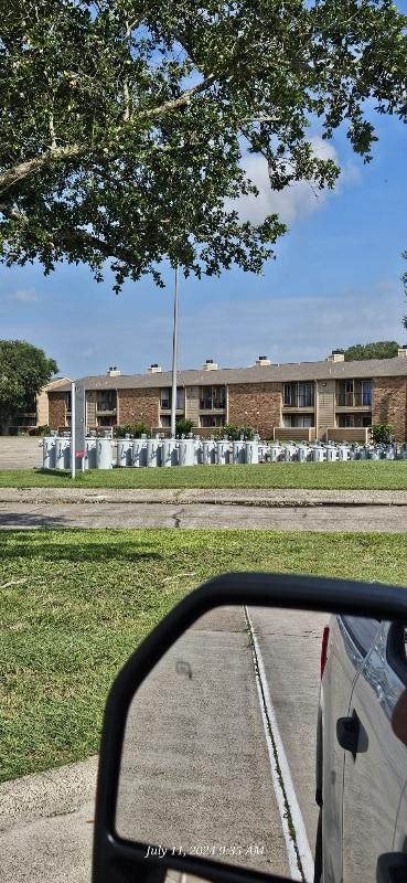

I live rural in between two small towns. It's encouraging to see the concentration of trucks, equipment, and linemen everywhere.
Ford F-150 Pro Power Onboard not displayed in App 20240711_113213
Just one of many depots setup.
Now get those things hung!

Yes, you have the old version and we are all jealous you jerk
