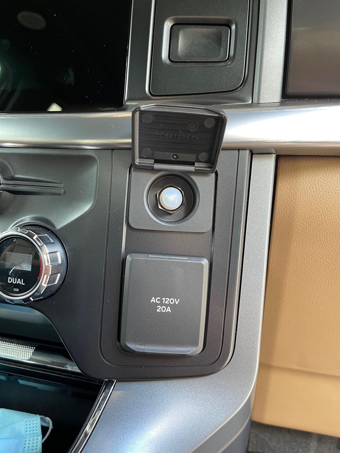

That is the same message I used to get. I kept going to the back and pushing the reset breakers in the bed but it would never go away. After I pushed the breaker reset in the cabin I never saw it again.
Start the truck, then hit the breaker button in the cabin. I will go take a pic now for you. When you push it hold it a second. That should fix the problem. Be back with a pic in a sec.

The 120v top white button is the breaker reset. Let me know how it goes.
