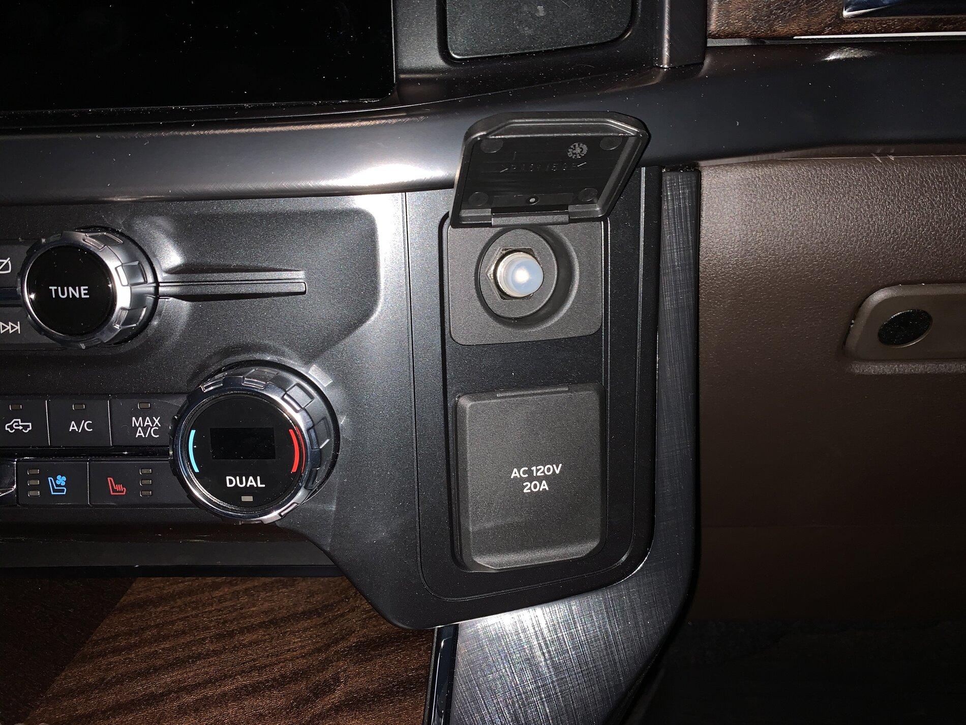

If someone could post a quick picture of the interior breaker on the dashboard it would be great. I don't think I've seen it in anyone's interior pictures. Is it under the plastic flip cover that covers the 110V outlet on the dash? Thanks!

Just saw this picture in another thread, is the breaker the very small round button in the top right hand corner of the 110V plug?
Ford F-150 Pro Power Onboard Breaker Tripped 3F24C8FC-BD12-4625-8E31-A731BEECC153
It's this guy (circled in red). When tripped, the white circular thing inside gets pushed out. Press it back in and it latches.
