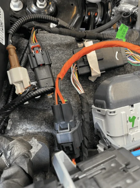

Eric, thank you so much for your help, very much appreciated. I drove to the dealer today to pickup the license plates and while I was waiting, I popped the hood, and look what I found (see before and after)!!!
When I turned the truck on, no ford pass error messages or dashboard messages. When I got home, I connected a heat gun to both front and rear cabin outlets, no issues. I then tested the bed outlets since I got my LINE-X done today as well, no issues.
I can now cancel my 9/7/2021 dealer appt!!!
Thanks again!!!

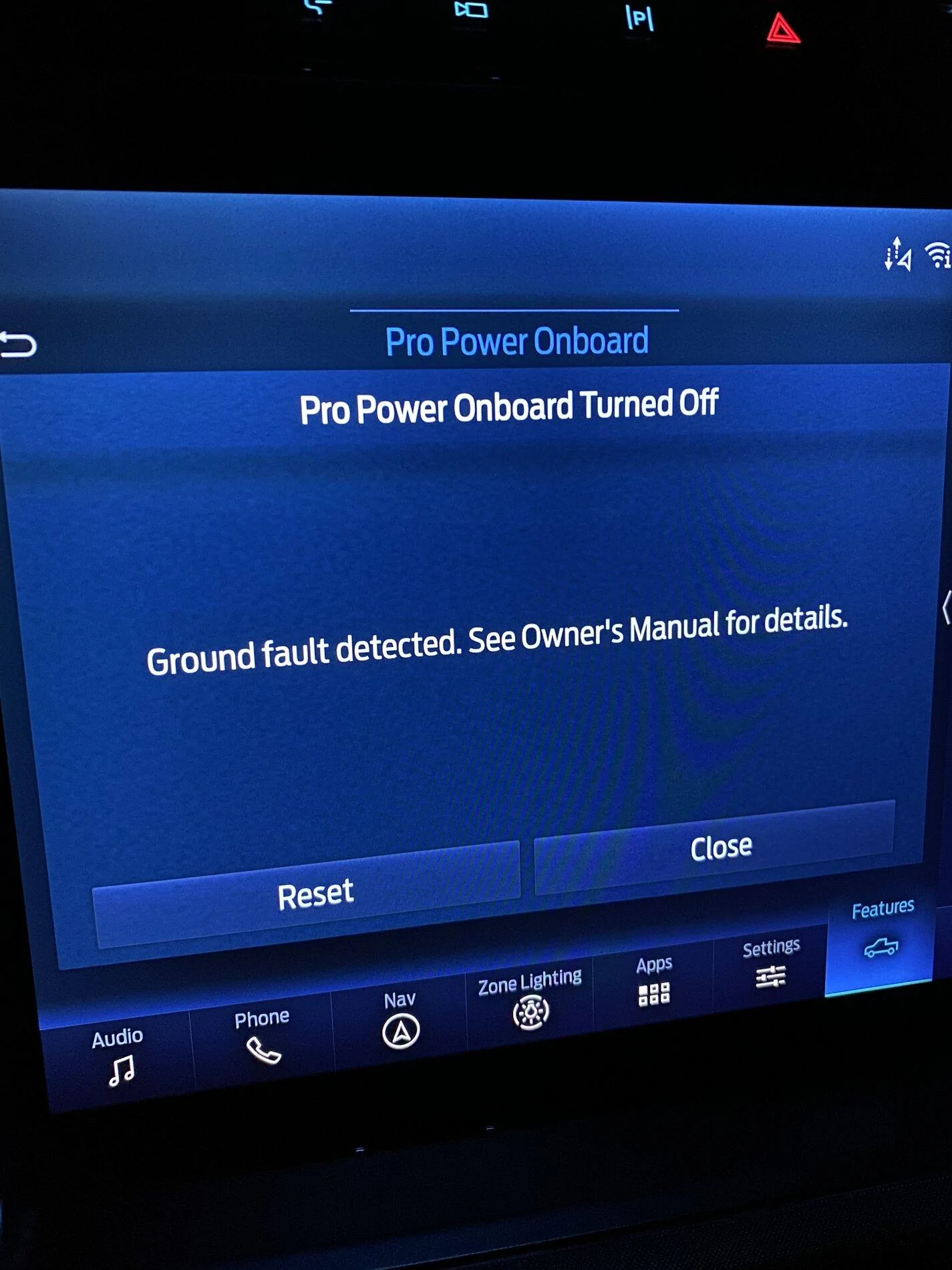

Appreciate this thread. I checked my pb platinum w the ground fault issue since delivery . Made sure that harness was tight . 1300 mile trip no generator fault w low power on the whole way ( a first for me in this truck). When home went to wash truck . Ground fault appeared as i drove in over underwash .. what does this say ? A circuit under the truck getting wet creates the flaw ? This cannot be the way they design thing right ?
