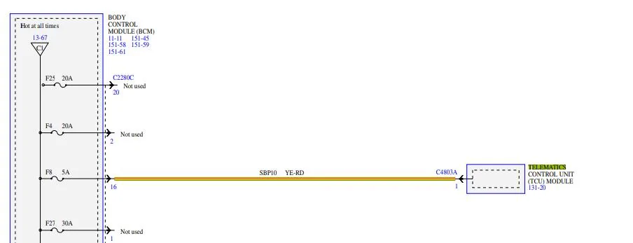

You can check this out.....

I think I'm interpreting your diagram correctly, that it's hot at all times. I need a pin that is switched on and off with the key.
Also if you have a pinout on that connector handy, that will save me some time.
Most of the truck's modules are always live.

I use fuse 34 on the fuse block behind the passenger kick panel for a switched cct for my dash camera. TCU feed may come alive when you walk by or a different times the truck reports to Ford.
