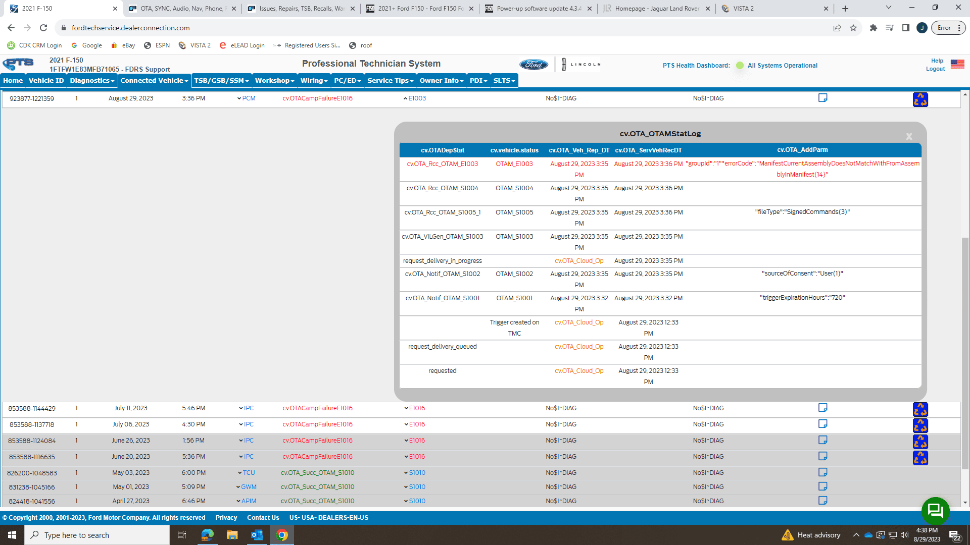

This update failed on my truck today due to a manifest mismatch. My truck has a tune, but I confirmed with Livernois that other trucks with their tunes have gotten this update sent to it successfully and it overwrote the tune on the truck. For once, I have no complaints about an OTA failing. lol
