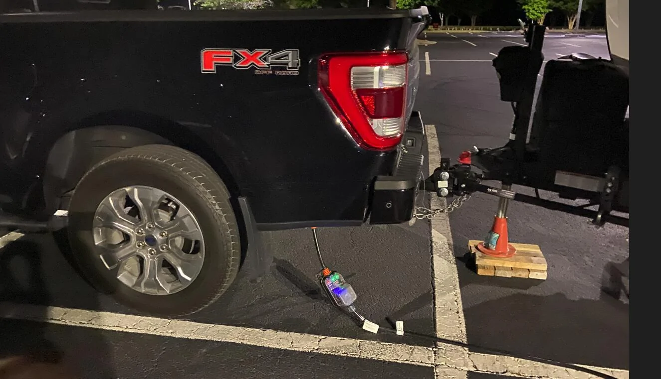

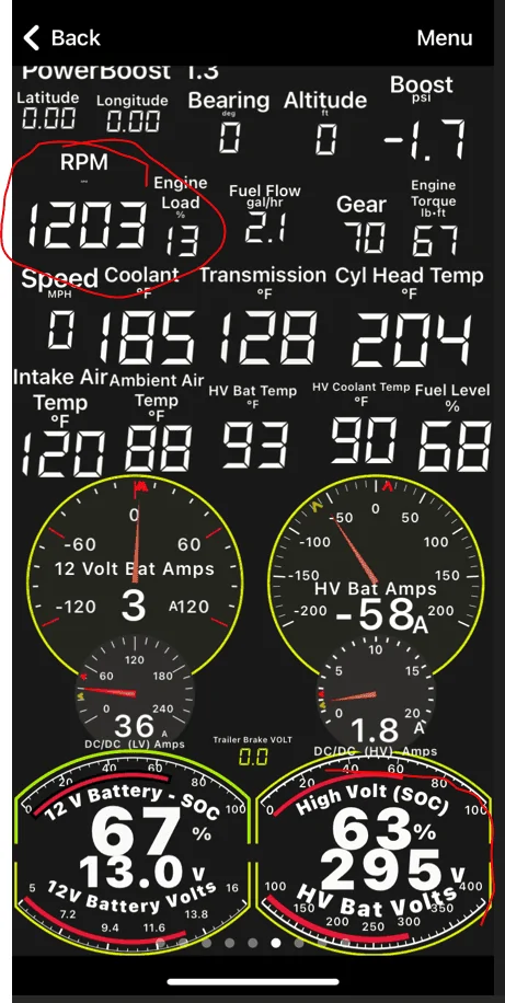

So today I ran a 30+ minute test on my 7.2kW Pro Power OnBoard. Ran my camper's Mach8 A/C unit on Cool Low setting. The PPOB drew 1280-1340 Watts on the "B" Leg during my testing. I did run the 1100 watt microwave for about 15 seconds to test while the A/C was running and it didn't trip the PPOB. Both on was pulling around 2690 Watts. So the PPOB ran for 10.5-11 minutes each time and was powering my TT A/C unit, then ICE would turn and charge the Hybrid battery to 63% up from 40 % in about 1.25 minutes (fast idle setting on) and would turn off. See stopwatch Lap1 PPOB, Lap 2 ICE on, Lap 3 PPOB, Lap4 ICE charging battery, Lap5 PPOB, Lap6 ICE. The A/C was drawing around 6.7 amps and when the microwave was on it 11.3 amps. I had all other trucks options like HVAC and seat cooling turned off. I have an upcoming trip planned and going to overnight non-hookups at Bass Pro Shop, so I wanted to test it. Last time I ran tests the ICE would stay running but I was over 12 amps with having the truck's A/C on. Just thought I would share my results with the group. BTW, I did add a 30 amp TT receptacle under my truck and have a whip running up to plug into the PPOB outlet.

June 28th Update: Boondocked at Bass Pro Shop on June 8th. Ran the PPOB for 13 hours powering my 20FBS E-PRO trailer running the A/C unit, lights, & TV. Around 1300 watts. It almost worked perfectly but the around 5AM the truck stopped cycling off/on and just ran until I turned off the PPOB and restarted the truck around 7:30 am. I wasn't pulling that many amps because I ran the TT A/C on low cool and didn't have anything else running overnight. Also had the truck A/C off. I thought I read something in one of the treads about someone's truck acting the same way. Ran fine for hours then stopped cycling. Any thoughts? I was going to try to test this weekend to see if I can replicate the issue. Before any one comments, yes I use my surge protector because it is easier to hook up power my TT.
I've had this happen once. I couldn't get the truck to stop running. The only thing I could figure is I left the truck's heater on. I ended up shutting the truck off for a couple of hours. When I re- started the truck I made sure the heater/ac and the fan was off. I haven't had a problem since.
