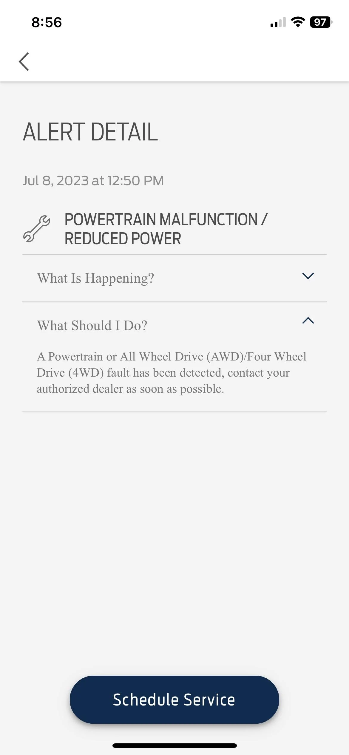

Hello, found some on this subject, but seems pretty varied. Trying to understand if okay to drive. Message showed up yesterday on 2021 powerboost. I am unable to change the drive modes. Says 4x4 fault and to service soon.
“A powertrain or all wheel drive/four wheel drive fault has been detected“. It’s Only in standard drive mode now. I was in eco when it started. Drove okay the 10 miles or so home after message. Started it this morning and the message was still there. Any thoughts?
Ford F-150 Powertrain or a 4x4 drive fault IMG_4728
Need the codes or vin for someone with the software to pull codes OTA. You can also go to a autoparts store to get the codes if you don't have a reader.

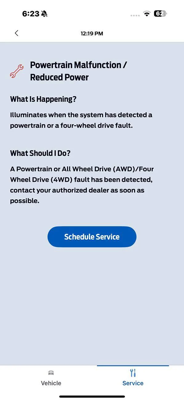

Got the same message this morning never had an issue before
From what I'm seeing this seems like a generic message that can be a number of different faults. I'm currently dealing with this situation right now and waiting on a new GSM for my truck to come in. My truck is currently fine other than the wrench light coming on intermittently.
