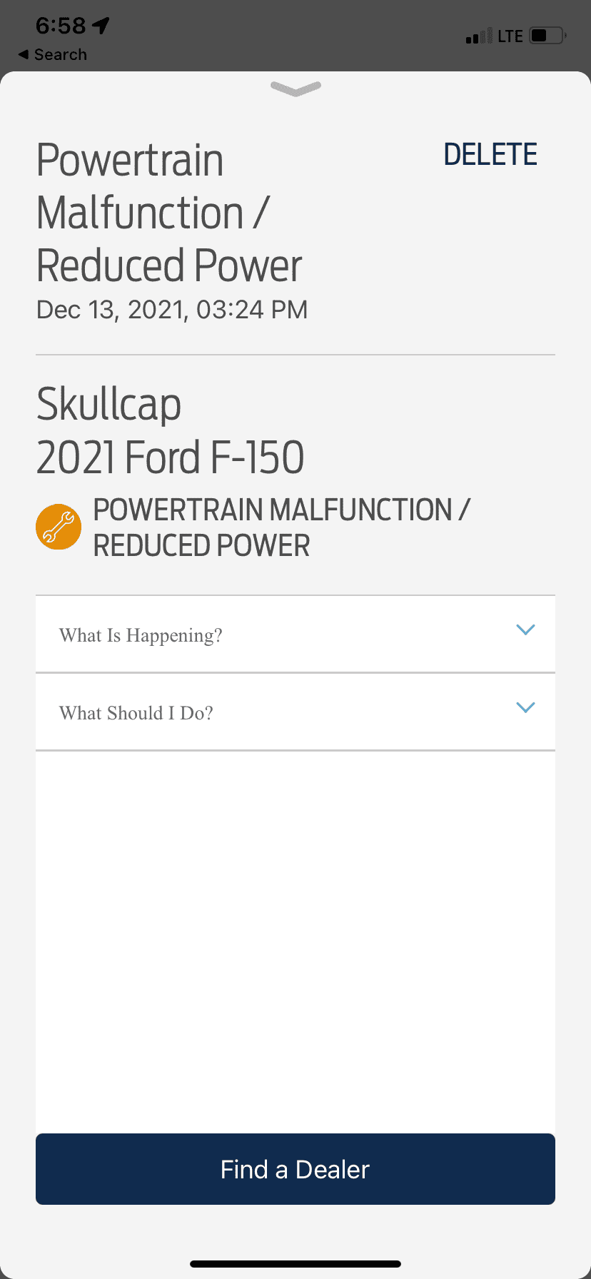

Hi All, new to the forum, and I believe this is the right place to post my story... basically 3 dealer visits (2 separate dealers), and I am now having this happen to me for the third time... first time, towed to dealer 1, (powertrain malfunction/reduced power on fordpass) they did a bunch of updates to the system, drove fine for 2 days, happened again (no error on fordpass), Towed to dealer 1 again, they could not look at it for 3 days, when they did they said it worked fine, and as there were no errors, they could not find a problem (sat parked long enough?), So after some thought, I picked it up from there, and drove it to dealer 2, I bought truck from, expressing my concerns that this is now a untrustworthy vehicle, no piece of mind, etc etc.... they had it for 7 days, and could not duplicate the issue. got it back, put about 600kms on it, and just got home tonite and it happened again.... I did go through a carwash today. I cannot tell you the timing on Carwashes vs the first 2 times it happened, but I certainly had it washed. hoping someone has some input, better than the dealers
Ford F-150 Powertrain Malfunction/Reduced Power IMG_7237.PNG
